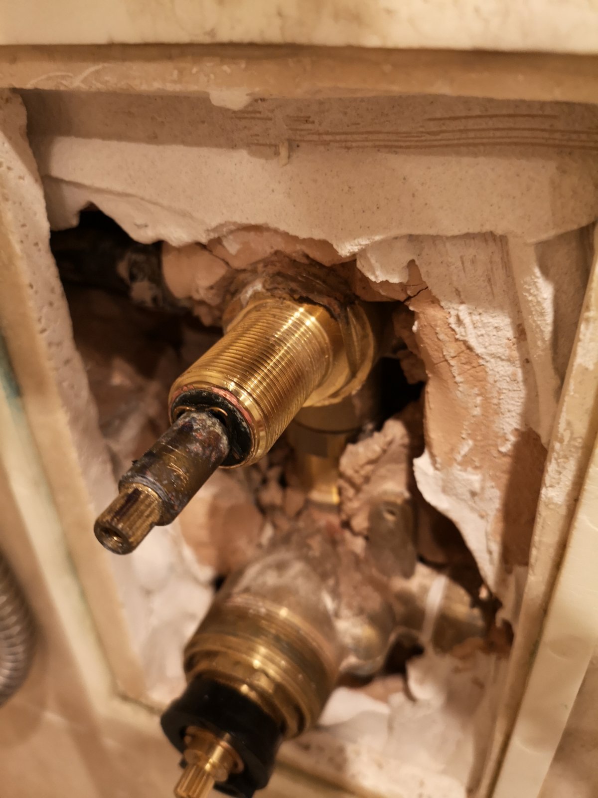

Next stop was going to be descale/replace the shower diverter valve in case it had any build up restricting the flow. Unfortunately I’m a bit stuck on how to take this off as there does not seem to be a break between where the threading bit ends and the body begins. Considering there is a nut shape there and a retaining clip at the front end, I’m thinking its just screwed together well enough to not show the joint and one of those plumbing box spanner sets should be able to undo this?

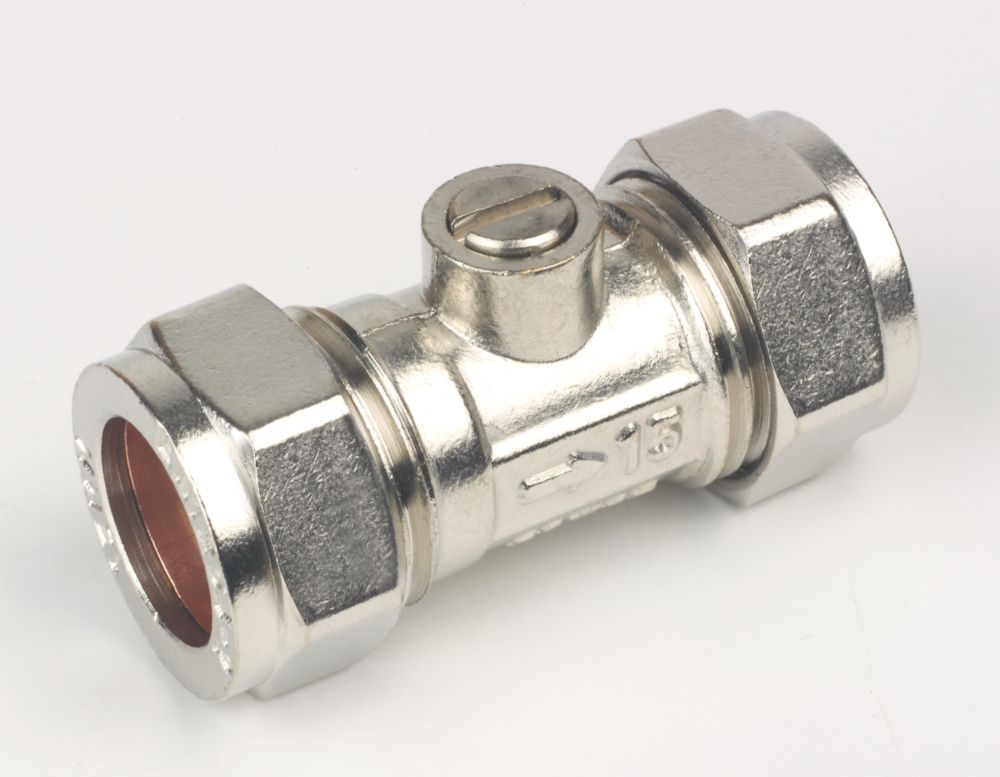

btw look for any of these little isolating valves, or flexible braided connection hoses
ae235
how many litres per minute?
ae235
Can't spot anything like that, probably hidden behind the tiling! As I'm getting continuous hot water to the bath outlet, I am deducing that everything between the boiler and the new thermostat is working fine. Have some of the box spanners on order so I can get to the diverter valve.

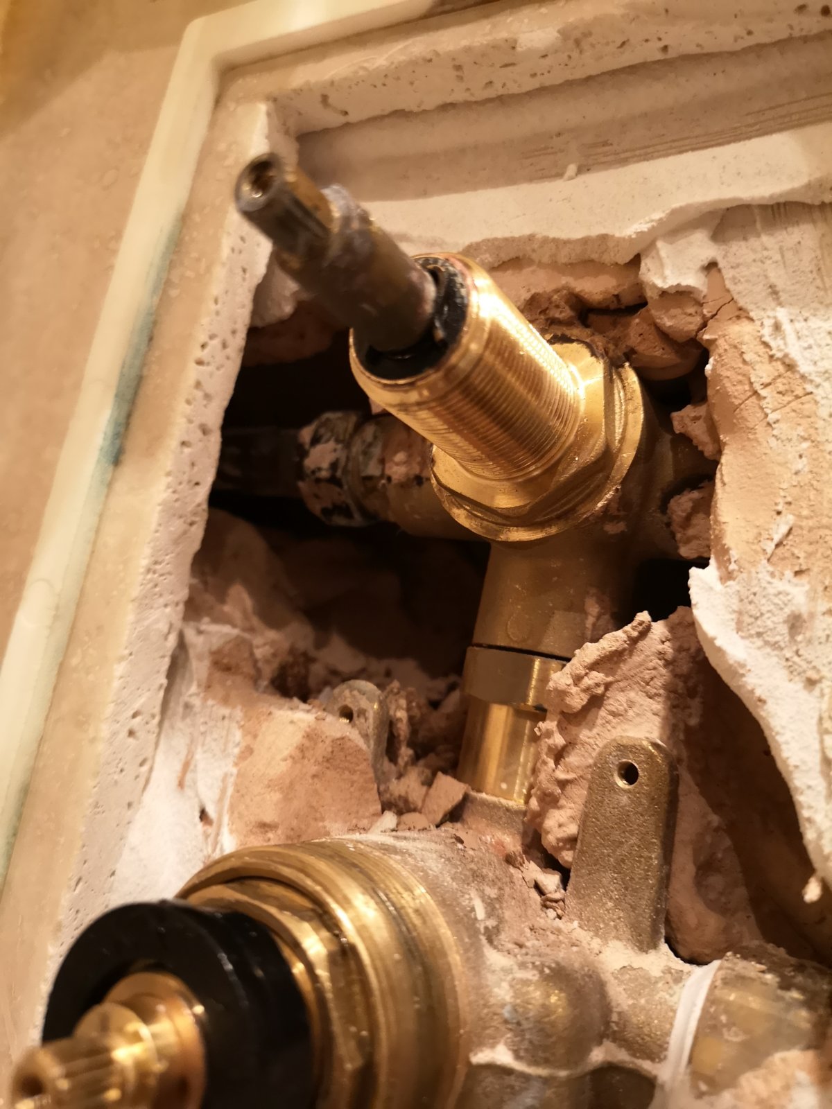

So I am getting 9l per minute from the bathtub outlet and 6l per minute from the shower (with or without shower head). So looks very likely that there is a problem with the shower diverter valve.

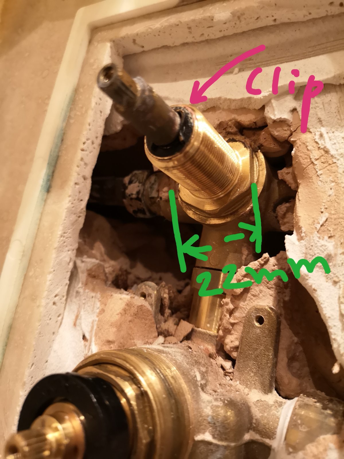

Unfortunately I am unable to get into the diverter assembly to descale/replace it. There is a retaining clip I can get off fairly easily but there is a nut which I measure across at 22mm using an adjustable wrench. It is a bit recessed so I can’t use the adjustable wrench for this and I can’t seem to find the right size tool. I bought a socket set off amazon which goes up to 22mm, but the largest one is too small to fit. Then I found a 22mm basin wrench on screwfix, the 22mm side of which is too big! How can two things claiming to be 22mm be so widely different!? (I’m clearly missing something quite basic here!)
Any help with this goldilocks problem much appreciated!
https://www.amazon.co.uk/gp/product/B00B3T3X1A
https://www.screwfix.com/p/basin-wrench/13294
I think I might have been a numpty while measuring the size of the backnut and what I need is a bigger tube spanner
