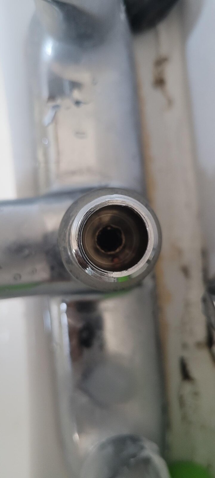

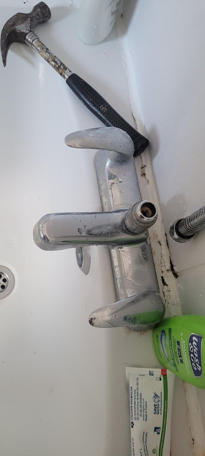

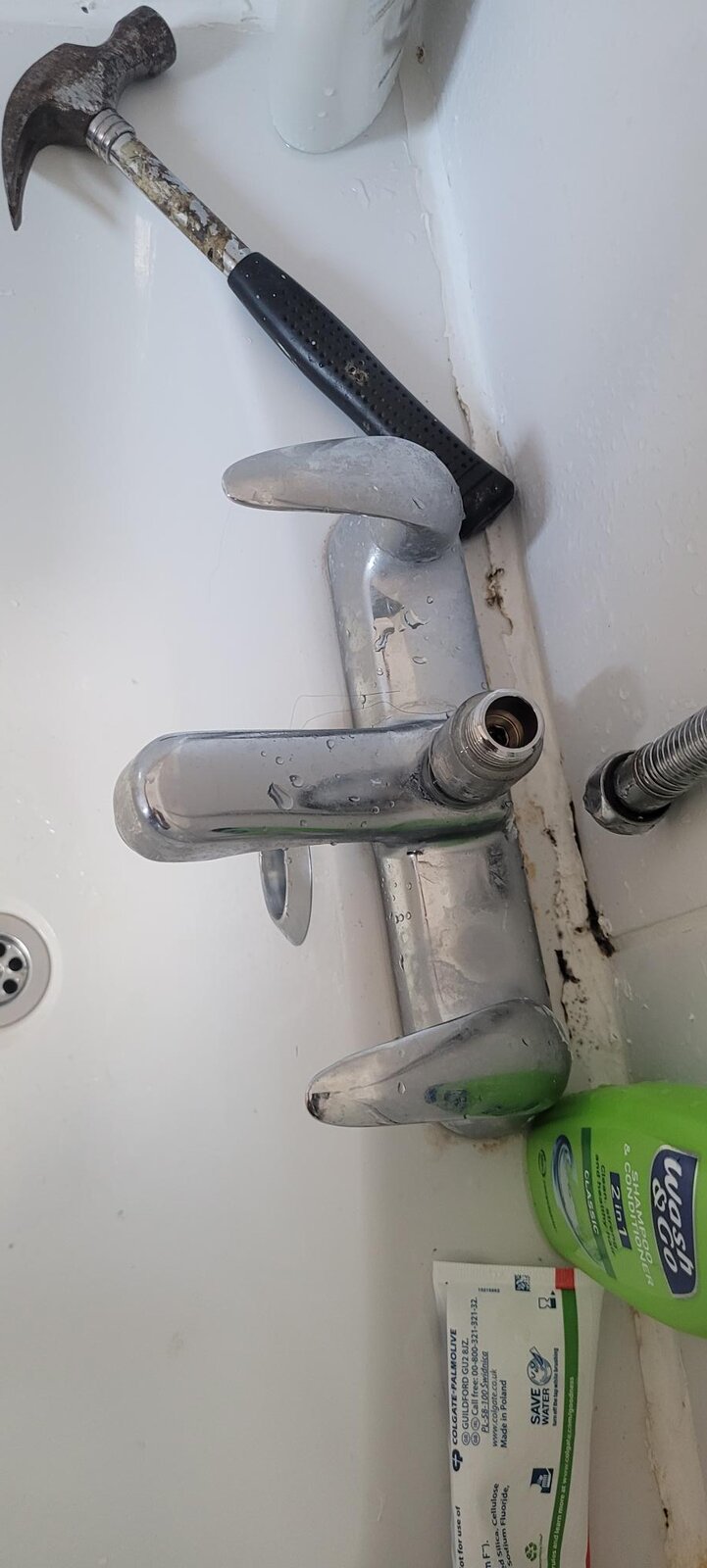

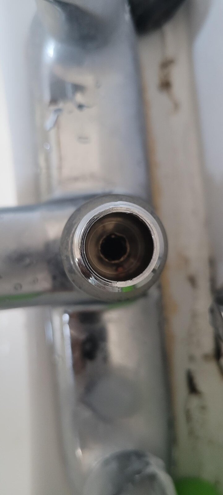

I have tap in pic half the water is coming out of the tap and half the shower how do i change trhe divertor valve or do i need a new tap
Usually a spring in there to maintain position, may be worn or snapped.
Excess lime scale can prevent it opening fully so make sure it’s all clean.
