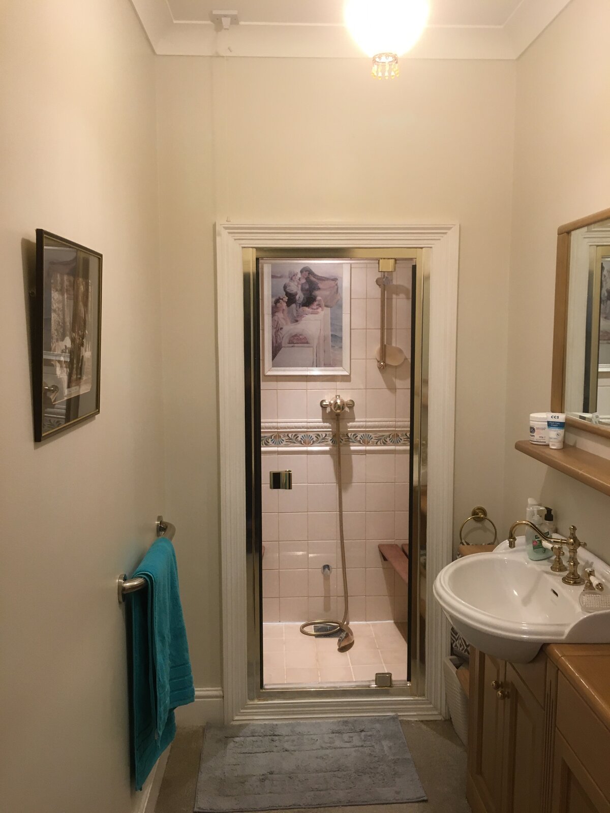

I have a room 3000 long x 1400 wide 2700mm height which has a shower enclosure, pan and basin
The shower enclose I want to alter to be a walk in wet room about 1200mm depth but I am trying to get my head around the ceiling height as I think it would not look right being about 600mm above the glass screen.
I have thought about dropping the ceiling height to about 2200mm through the area of the wet room but I am unsure how I could form the ceiling which would give me access to above for plumbing electrics etc but the outer edge would look right as seen from the room.
Any ideas appreciated
it’ll look top heavy and irregular.
is this your own idea or have you seen it somewhere else?
What I have at the moment is a shower door (1800 X 750mm ) in a stud wall, as attached.
The depth of the shower floor is 750mm but by removing the stud and pinching some of the room I can increase this depth to around 1400mm
The reason for the change is medical
