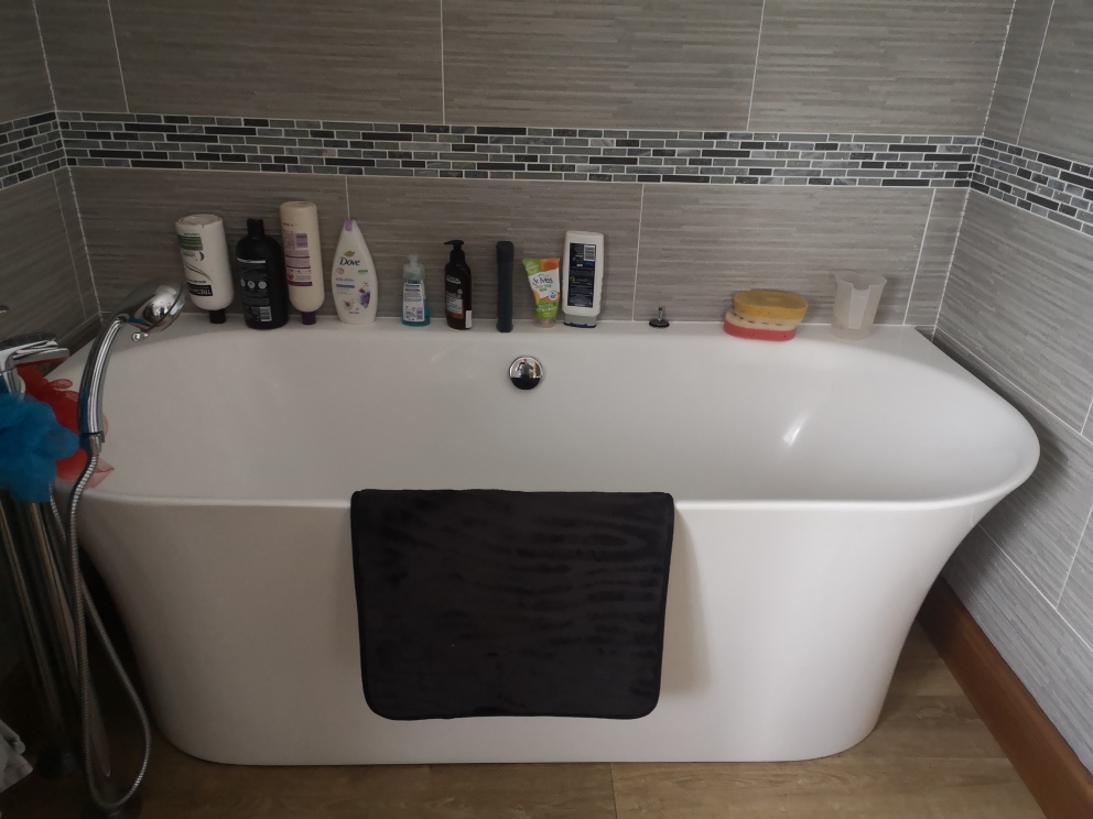

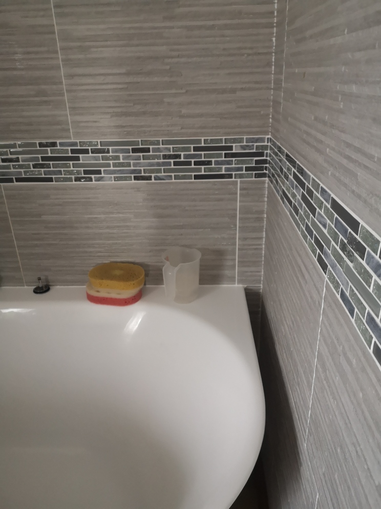

Hi
I have recently moved into a property which the previous owner has installed a free standing bath. I am looking to install a shower on the wall. The bath has a gap at both ends and I am concerned about water going down the side of the bath. The previous owner hasn't made the best job of the bath install and water splashing out of the bath gets through the ceiling downstairs. I guess a filler plate to fill the gap between the bath and wall maybe required(thinking of mounting the shower on the RHS of the bath) but I think this may look a bit of a bodge. The house has a low pressure system so going to go down the route of an electric shower with a mains fed cold water inlet. Has anyone experience of screening these baths off? I think the best shower would be a ceiling mounted one but no electric versions are available.

That type of bath isn't really suitable for a shower to be mounted above it.
That's a 'back to the wall' slipper bath, with the squared rear section it's a bit of a hybrid between a free standing and and normal wall sealed bath. Don't see many of them as they're a pain in the a$$. With that type of bath though the floor should be fully sealed so any water escapes has no where to head down.
There should also be clear access all around it too to ensure water can be dried up properly.

Why is the BTW bath not suitable for mounting of a wall shower. I can see the problem of the sides being open but from what I have seen on the net free standing baths can have wall showers mounted on the wall beside them
It's not that it isn't suitable per sé, it just isn't really practical as the shower can't be contained where the wall to bath seal should be waterproof and there is a proper shower screen/curtain.

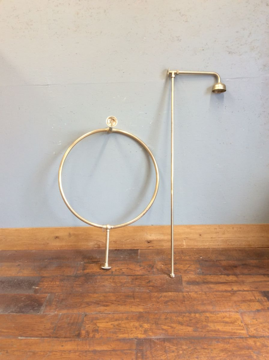

The only showers I've ever seen for a freestanding have a circular/oval shower curtain with an overhead rain shower and IMO they just don't look like they're meant to be there. These types of bath weren't really designed to have showers, hence their shape is more for lying in rather than standing in.
Hi thanks for the info. I have been considering the circular curtain but I believe as your picture shows a ceiling mounted shower head. We are on a low pressure system here and an electric shower is the only real option and these aren't suitable for ceiling mounting. It is unfortunate that the previous owner installed this type of Bath as it was installed shortly before we bought the property which makes ripping it out a bit of a waste

as suggested you do get oval ones too
