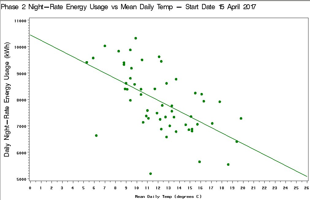

Interesting question, and I have at least one additional suggestion. I've been carefully monitoring my electricity usage for some time and was intrigued to see that the night-time consumption on one of my phases had been appreciably and progressively falling for the last couple of months, despite nothing obvious having been changed (by me!) .....
On consideration/investigation, it seems that the reason was my water heating. It is heated by immersion during the night (cheap E7 hours) and used during the day. It appears that the cylinder could do with a bit more lagging (it already has a lot), since it seems that this phenomenon has been due to reduced heat loss from the cylinder (hence less heating required the next night) as the weather has warmed up. When I plotted this usage against Met Office figures for average daily temps in my area, there seems to be a pretty good correlation ...
... so that is perhaps one component of the explanation. Of course, fridges and freezers have to work a bit harder in hot weather, so I suppose that at least partially cancels out the water heating issue.
