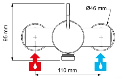

Are the pipe centres/position uniform for all exposed mixers?
Edit- so you too think that the thermostatic valve is at fault rather than the combi?
Yes, the distance beteween the outlets is standard and if all the other hot taps are working correctly then it is the shower bar that is faulty.

I think the mini duo has closer centres than the normal 150mm.
