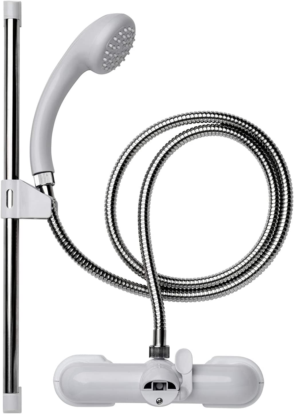

I put "shower" in quotation marks because all I have is one of the cheapy abominations pictured below.

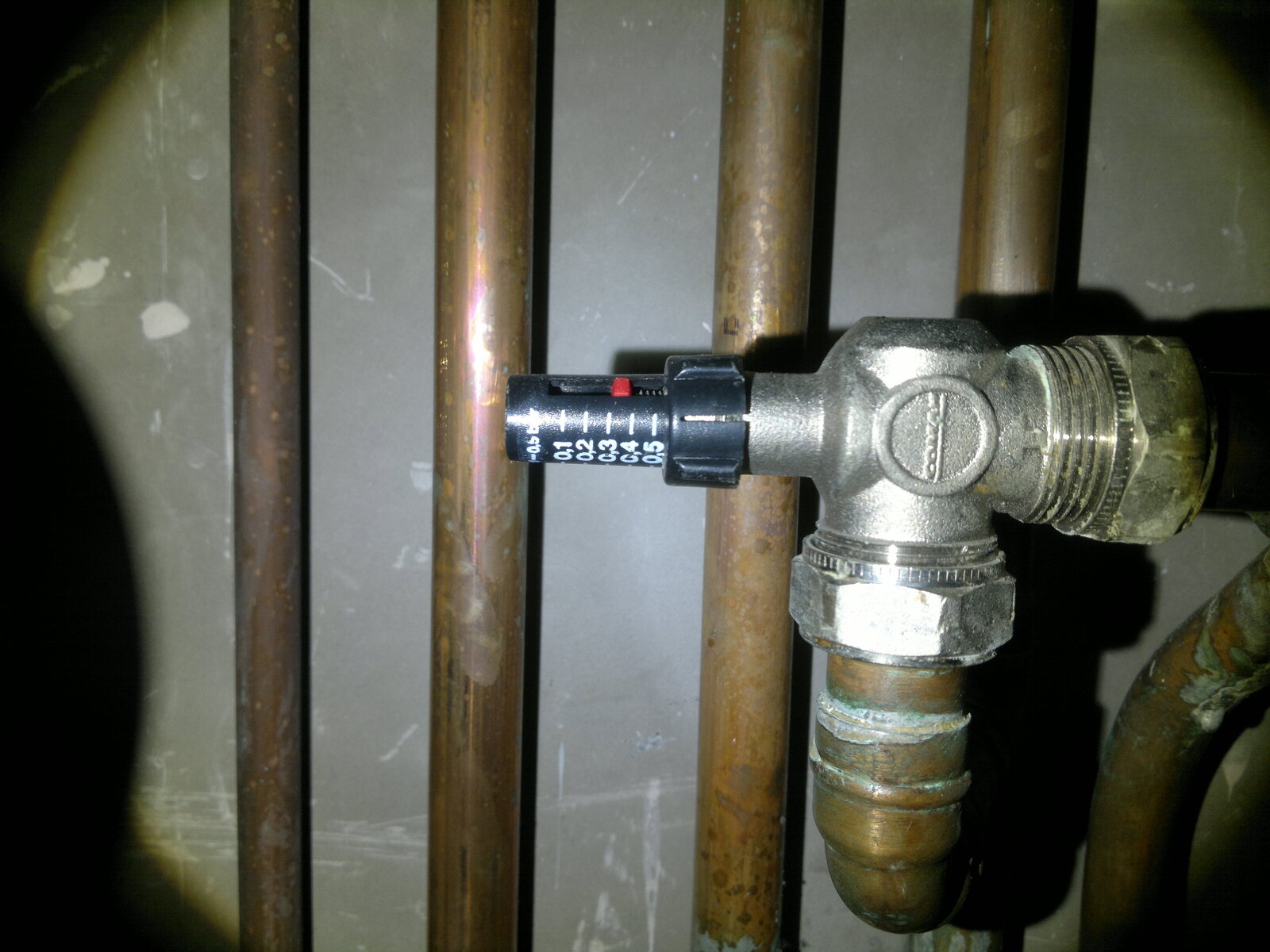

I pointed out the to guy that did the service that a valve in the hot press seems to be rattling. Although this only seems to happen when the central heating is on. It doesn't rattle when hot water is being used in the shower or sinks, so it might be completely irrelevant.

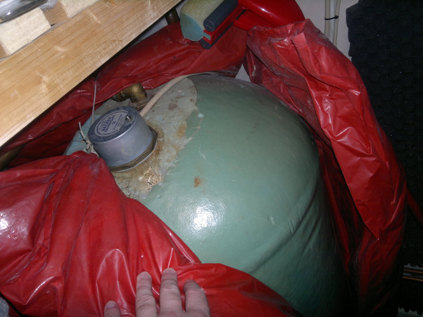

Have you got a hot-water cylinder? What colour?

Yes I do. I'd say it's turqoise.

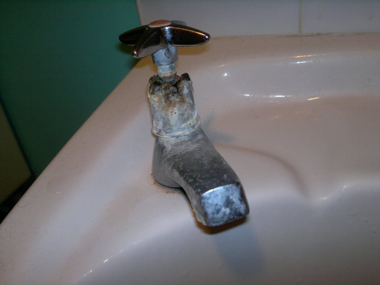

If I perform the test you suggested on the bathroom sink, I'm concerned that the top might blow off this tap... Water already leaks from the corroded area when I run it. The top is wobbly.
You might get a dribble of water, but it won't burst.
Is the green paint on metal, or plastic foam?

And what's the relevance of what material my cylinder is made from?
I was checking that it is a low pressure cylinder.
Green cylinders are usually copper, with green-coloured foam. Your looks painted which I have not seen before. The older one was yellow-coloured foam. Newer ones are blue-coloured foam and the specification is different. White cylinders are usually high pressure, with a secondary steel casing over the insulation. So the colour is often helpful.

What tap is that?
The shower mixer you have doesn't come up on a search so we don't know what it is. Does it have separate controls for temperature and flow?
Don't worry your hot water cylinder appearance is perfectly standard.

If the white mixer thing is thermostatic and the cold is restrticted it would restrict the hot as well, but "thermostatic" implies no separate taps, so you'll have to give us more info.
Rattles are more likely to be a valve or pump in the central heating , in which case aren't related.

Sorry, I thought that it was obvious from the picture that it was just one of those things that fits over your taps, from Croydex: https://www.croydex.co.uk/product-7.html Since it's so basic I thought it very unlikely to be the problem. It has a good seal around the taps and there's no leaks from it.
This is the thing, knowing not really anything about plumbing, I know there is a pump in the hot press, but I believe it's for the central heating. I'm assuming there is also a separate pump to pump water out of the cylinder into the bathroom...?
