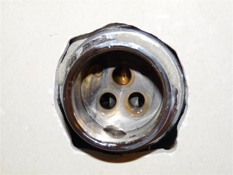

Well I decided to take a feed from where the pipes arrive under the bath (before they go up in to the wall) and just run it in to the bath tub itself with two push fit valves in place.
WOW!
Had a hand from someone else and opened the valves at the same time and the amount of water and pressure took us both by surprise....
It was almost like both were under mains pressure...the pump was running not problems and was really pushing some water though the pipes.
I guess this leads to only one conclusion....the mixer itself is rubbish.

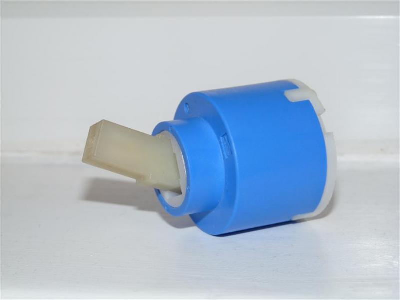

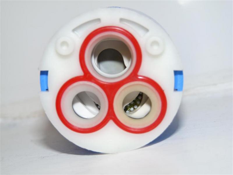

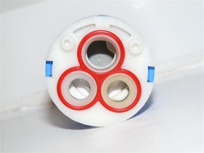

I notices I could unscrew the front of the mixer and take a look inside...pics of what I found are attached.
The first pic is the mixer without the cartridge installed.
The second is the cartridge.
The third is the cartridge fully closed.
The fourth is the cartridge full open.
As you can see from the fourth the gap the water is expected to go though is tiny and its no wonder the flow and pressure was poor.

Hi there,
I had the same issue as you with a Mira mixer shower and when i pulled it apart I had the same parts as those you have put pictures up of. I found that limescale had blocked the flow of water and having bought a new insert and installed it the presure was then fine. The insert cost me £10.00 from ebay and it's been working ever since.
Les.
thanks for the reply.
it was some time ago. in the end I went with a Mira mixer which allowed allot more flow than the original.... problem solved
