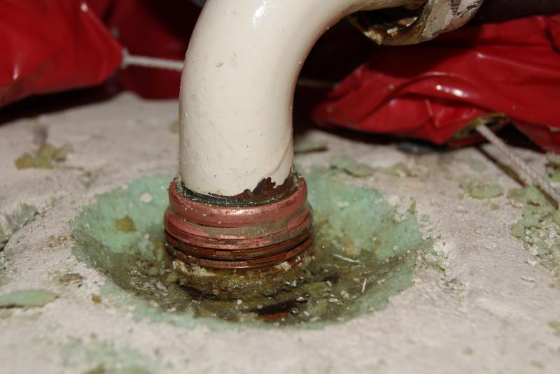

thanks dreadnaught, yup, it's a male thread. I undid the top 'nut' earlier when I had the cold tanks emptied, and it looked essentially like a compression fitting - male thread on the tank, and a nut on the top.
Could well be a 1" Male iron to copper such as: http://www.screwfix.com/p/male-coupler-22mm-x-1/61955 Screwed tightly into the female thread on the top of the cylinder it may appear to be part of the cylinder. In (too many) years, i've not seen a cylinder with male threads on the top of the dome either! ;)
Is your cylinder copper or stainless steel, (the stainless ones come with compression fittings ready for pipework)

Well, as the saying goes, 'everyday is a school day'. And I stand corrected, it does indeed look to be male compression fitting. :oops:
Suggest you now look at altering the draw-off/vent pipe as necessary.

Is that the type of fitting where the tube is swaged to form an 'olive'? Not seen (or made) those since college, and that is a distant memory now..... :cry:
Kingley Fittings,
the cylinder is too modern for those, is that not a tapered olive in the pic.
well, is that another twist?
do i need a special 'tapered' olive?? or should a regular one do? I was banking on just putting a regular 22nn olive on there and doing it up!
