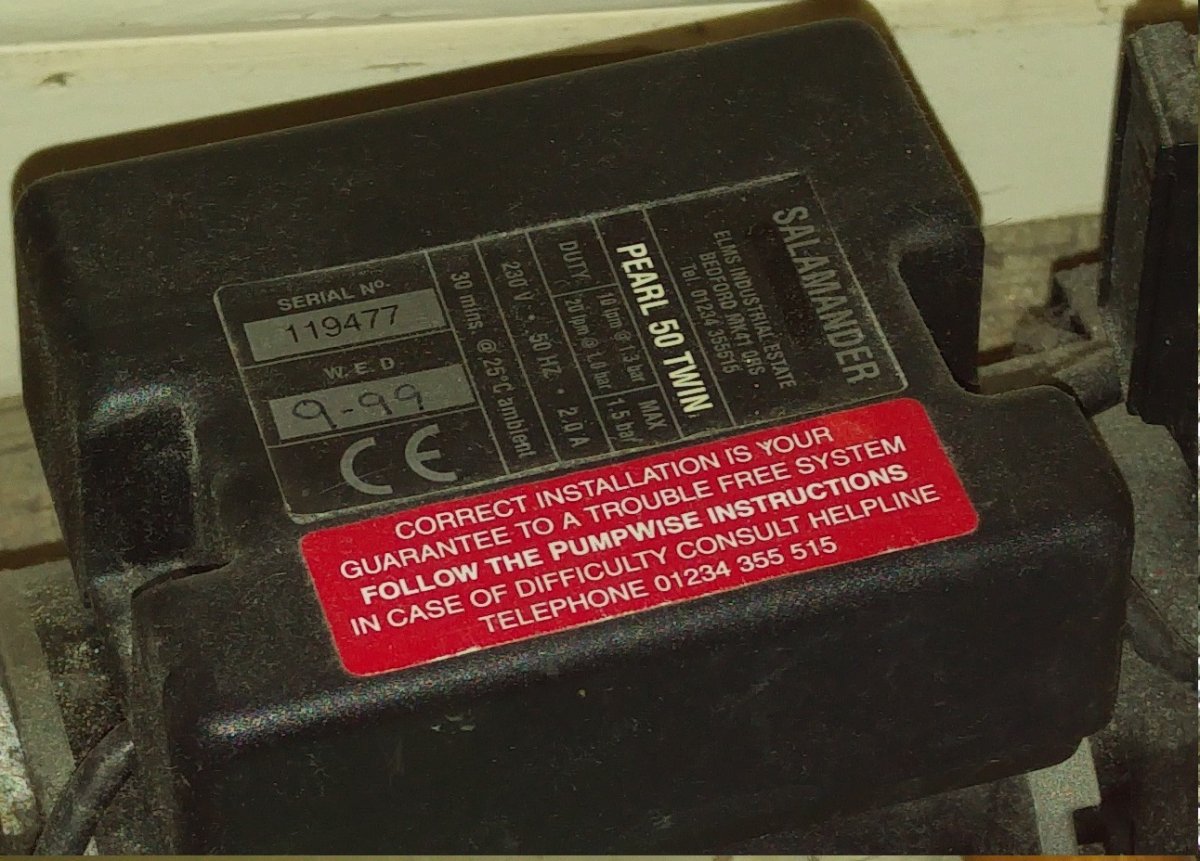

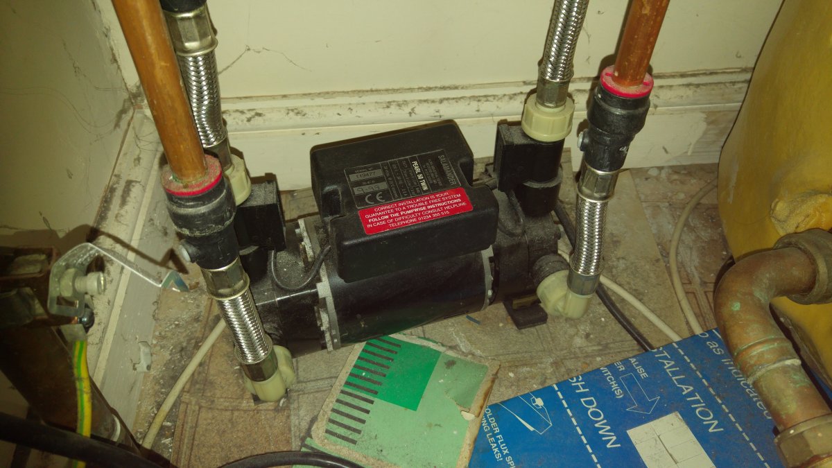

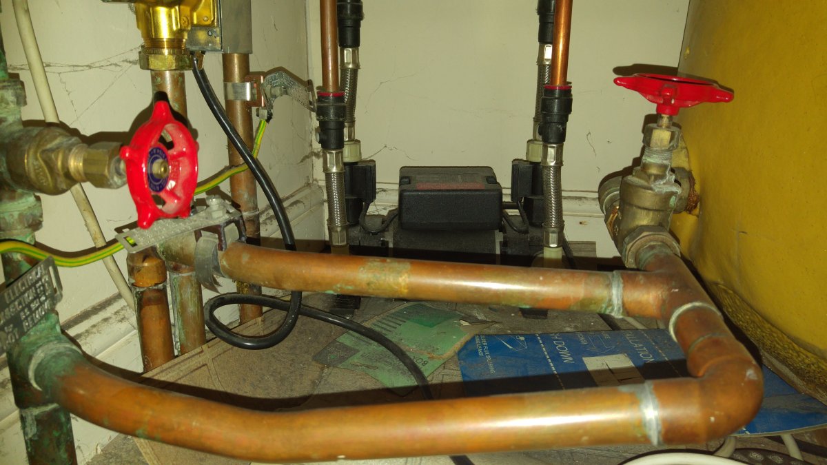

A shower pump Salamander installed in my property no longer works. The water pressure in the shower is poor. I am not certain if the pump also controlled the water pressure in the cistern, as that is now also very poor. I need to know the following:

1. They are not worth repairing
2. Fit it yourself, easy to do, turn off water to pump, turn off electric, disconnect the hoses by pulling back the red plastic bit that connects to the pipes and repeat reverse process to install new pump.

5. Install another pump near to the shower and hide it in a cupboard out of the way but so you can get to it should the need arise.

That pump is the better part of 20 years old, forget about any repair to it.
For now, it can be replaced with an equivalent item so that the shower works properly.
