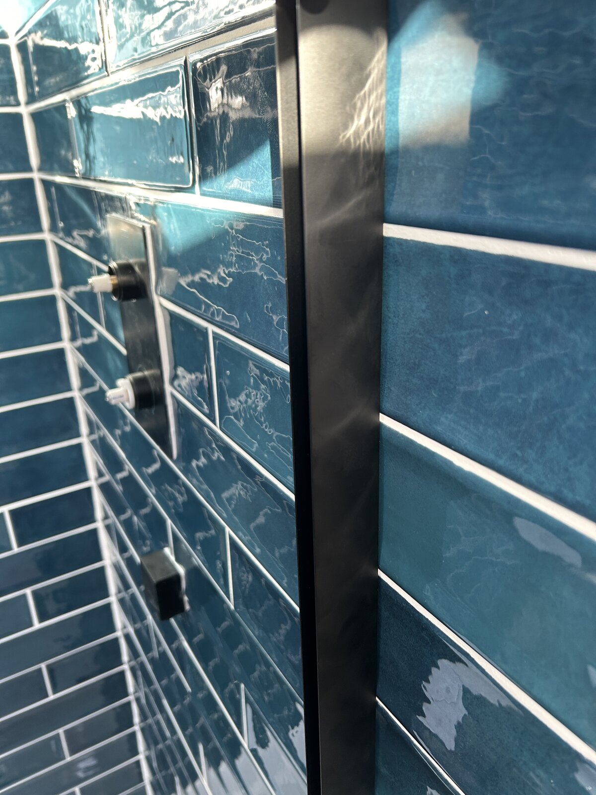

Hi, I am trying to shower screen on a newly tiled wall. The tiles are vertically level however the tiles dip down towards the centre of each tile. How do I fill the gap between the shower screen and the tiles?
How much do the tiles deviate? How about a butyl mastic strip sealant? You can get it in a 10mm diamter profile, it squashes down to suit. Then once the screen section is tightened up against the wall seal each side with silicone as normal?
