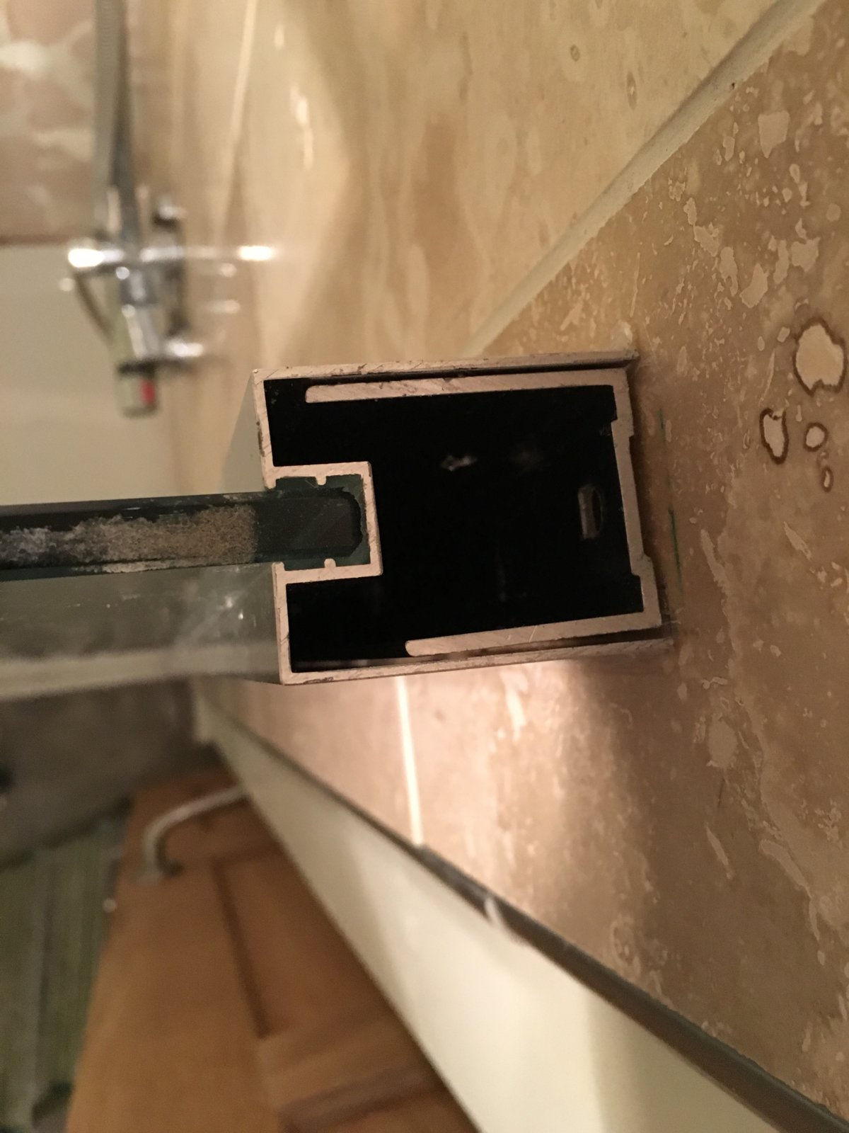

I can’t remove one of my shower screens I’ve taken the caps off, removed the screws and cut the silicone but it won’t budge.
It appears that the bracket is bolted to the wall and then another piece sits over it (please see picture from top of bracket)
I expect once the first channel is fixed to the wall you then clip the second one on and it latches on to grooves in the first channel. I'd have thought you may need to get something in the end on each side in between the channels and at the same time lever it away from the wall, once it starts to come away it should just come off, I wouldn't want to have to do it I'd not be confident of not breaking the glass but needs must. Are you hoping to refit the screen or is it being replaced?
Thanks it’s my intention to refit the screen once tiled.
Will try your suggestion
