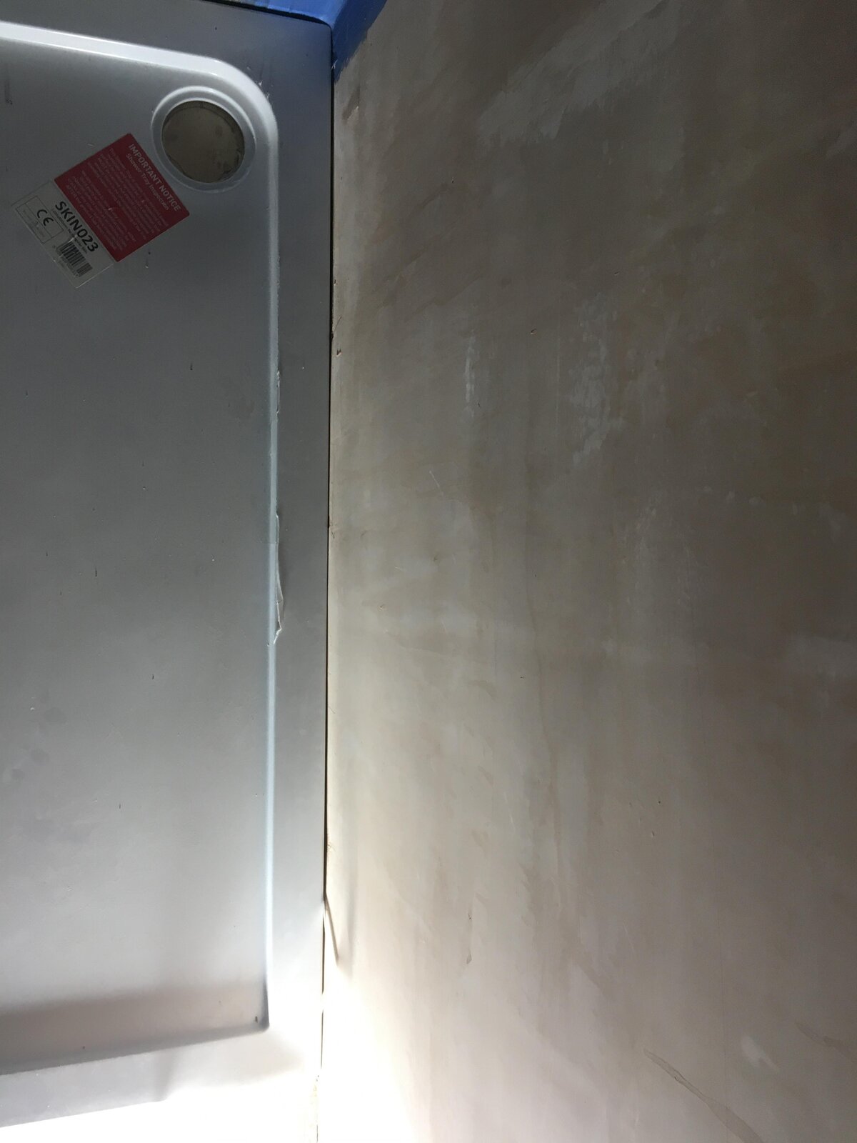

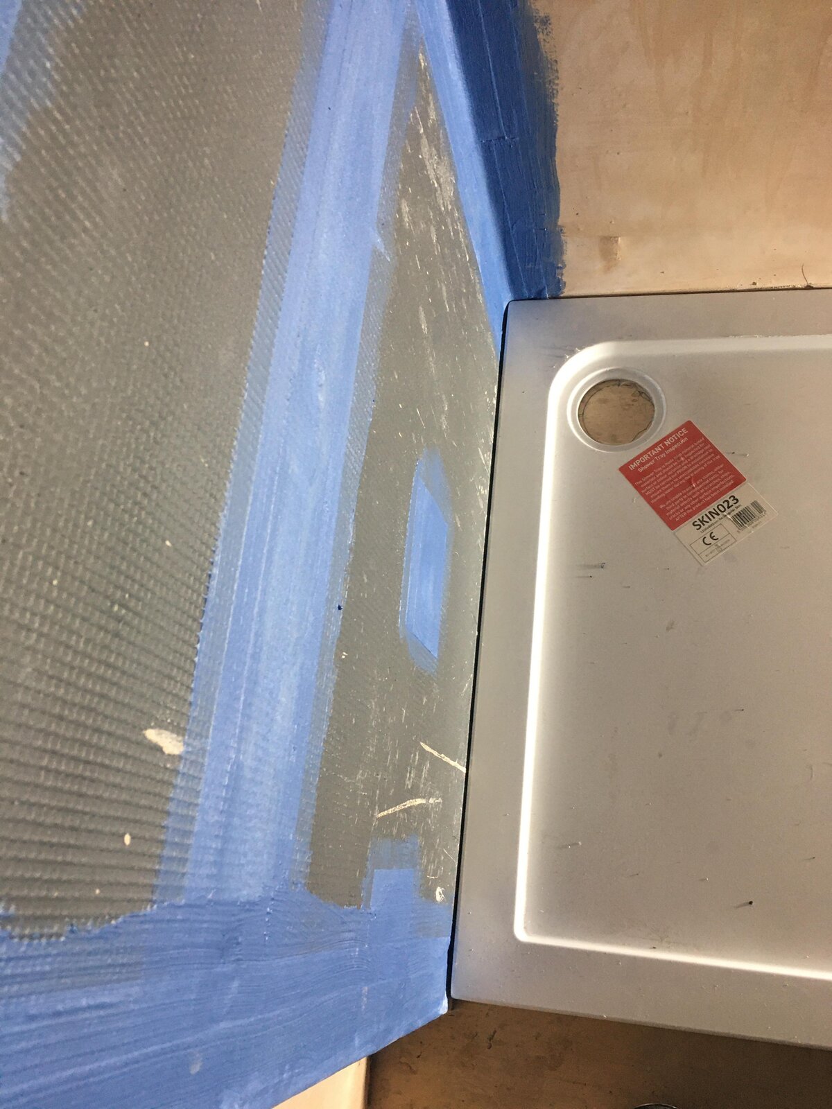

Hi Guys,
Just looking for some advice on fitting new shower tray. One wall is plastered, the other tileboard on studs. The tray edges are slightly tapered towards the bottom meaning the top is slightly away from the wall. I have cut away the plaster and board to allow the tray to sit somewhat closer near the floor. Plastered wall is fairly straight, but the thickness varies because of the brickwork.

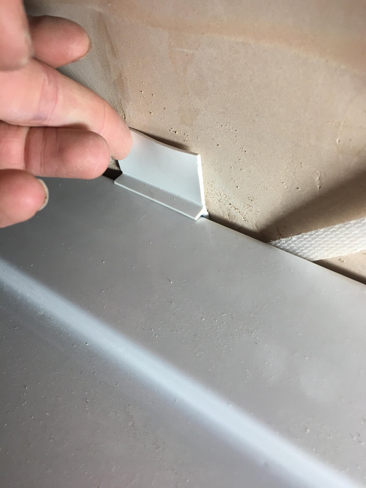

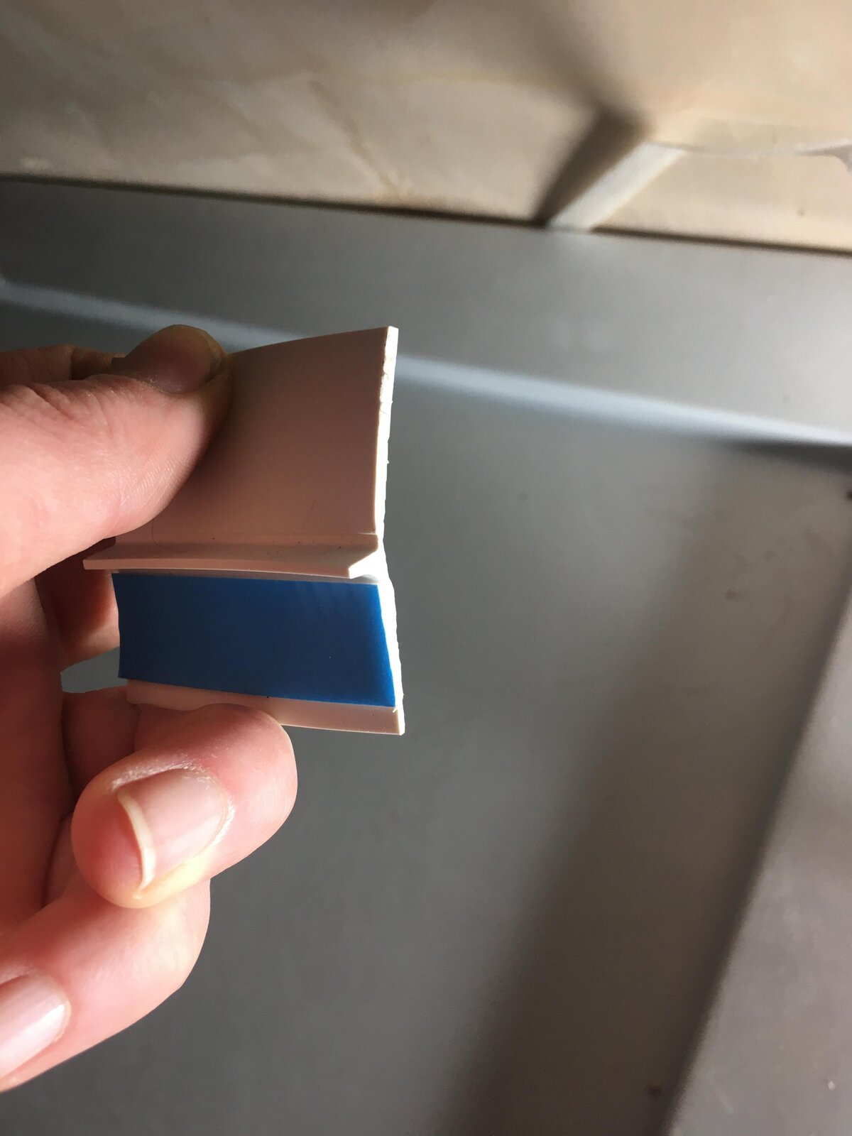

I was also planning to use a Mira T shaped sealing strip around the tray edge. Should I trim away further or will the strip and tiles take up the difference... I'm probably overthinking this, but just want to get it right. (images attached) Thanks!
122184372_801196173975523_2283576332180514_n.jpg 121633702_871917520223470_2248847472145366814_n.jpg 121733628_1051706291918243_7639406327693783438_n.jpg 121673593_632776337377512_3912045937835949768_n.jpg
Gap looks spot on. Tiles and adhesive will easily overhang the gap. Then a nice thin bead of silicone - you shouldn’t even need to flood an gap first.
Don’t go anywhere near those sealant strips.
You want to seal all the way around the tray.
Lift the tray, silicone all the way around the outside edge on the sides and the outside edge underneath so when you sit the tray back down the silicone squeezes and fills the whole gap between the wall and tray giving a you a full waterproof seal all the way around the outside edge. Run your finger around the top edge sealing the whole thing in and clean off any excess. If you then want to use a tile strip too then it goes in when the silicone is still soft though it's not really needed.
Make sure the tiles are fitted properly with horizonatally comb'd/flexible waterproof adhesive and grout.
