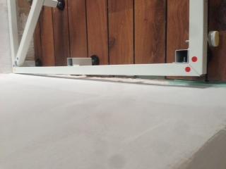

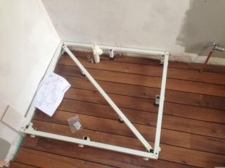

We are installing a new shower cubicle in our bathroom. The walls are block concrete with a plaster skim.
The problem we have is fairly standard I guess - the walls aren't right angles. So what I would love is some views / opinions on the two solutions I can think of - see below:
1. Chisel out a bit from the recessed corner wall so that the frame fits better into the space. And then also fit the frame in the middle of the space so that the gap is on both edges of the frame (and tray once installed). Hopefully with a bit of chiselling it will reduce the gap, plus I have some aqua strap for the tray once installed so hoping that will bridge the remaining gap to the wall and create a water tight seal

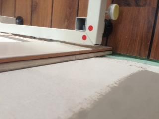

2. Position the frame flat against one wall and then tile into the space created on the other wall (see extra pic). Essentially build up the wall in that gap and then hope to level the wall through final tiling and a bit of on the fly adjustments with liberal use of tile adhesive etc
Any thoughts on proposed solutions - or better ones - gratefully received!

I cant see for sure but you appear to be leaving the skirting in behind your frame - this will push you off the wall, if its indeed the case.
The walls can be pulled out, and squared and plumbed, using cement backer boards.
Or rendering out floating coats of S&C similar to the backer boards.
FWIW: before any wet fixture work is started you must have a drainage outlet and a hot and cold supply designed in.
Might seem obvious but have you checked the frame itself is square (by measuring the two diagonals - only when they are the exact same dimension is the frame square.
My choice would be to build out one wall (or both if not flat) using a sheet of waterproof plywood and then cover with aquapanel or whatever before tiling.
You might want to consider building out one wall in any case to allow fitting of the shower pipework and valve assembly.

Thanks for advice - ended up boxing in one of the walls to create 90 degree angle and at same time create space for control valve
Works well and fit of tray to space so much better so worth the effort!
