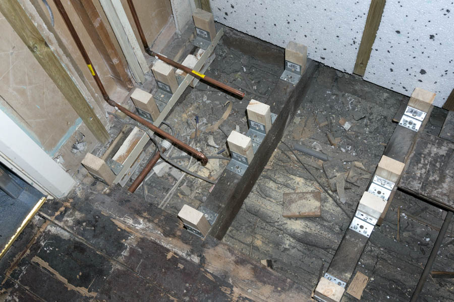

This is what I've done so far. Do you think I need dwangs between these support pillars? The brackets are very rigid. The base will be 18mm P5 grade chipboard. I could only find it in 600mm width and the shower is 700mm so I'm doing it in two pieces T&G'd in the centre, hence the double row of pillars down the middle. Aquadry panels on the sides.

Is this an upstairs bathroom? If so then single lengths of 40mm wide >90mm CLS at right angles sitting on the joists, then complete the rectangle on the left and right sides running on top of the joists with the centre piece would be inherently more stable. I see what you are trying to do but by doing that you are creating point loading on the joist rather than spreading the weight across the joists.
I wouldn't use a P5 chipboard top tbh unless it was going to be tanked. Even then though I'd still use WBP Ply (or OSB3 board if on a budget).

This was what the MIs said to use, with a mortar bed on top. You suggested earlier in the thread that I should tank the area anyway so I was going to look at that.
Alan
Just my professional opinion ... I would never use P5. When I'm installing a shower in a bathroom I will alway recommend replacing any P5 flooring anywhere in the room especially where it may get wet, it really is a recipe for disaster.
All the major bathroom reworks I have done over the last few years have involved replacing soaked and rotten P5 flooring somewhere. It just isn't good stuff to use where water may get to it.
