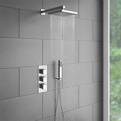

Yes, but you are aware that I want the controls on one wall and the rainfall head and handheld on the opposite wall of a 1000 x 800 shower?
No, it’s yet to be built. However the wall that will house the control valve is lathe and plaster. I ‘may’ be able to install a fully concealed valve, but cavity space is tight, I need to do some really accurate measuring and with a 12mm tile backer board and then a 10mm shower panel in front of that it should be possible.
I’ll then build a stud wall at the other end of 1000mm shower tray.
imagine this, but with the rainfall and handheld on the opposite wall.
my original post was in case I couldn’t fit the depth of a concealed valve within the cavity space I have available.
