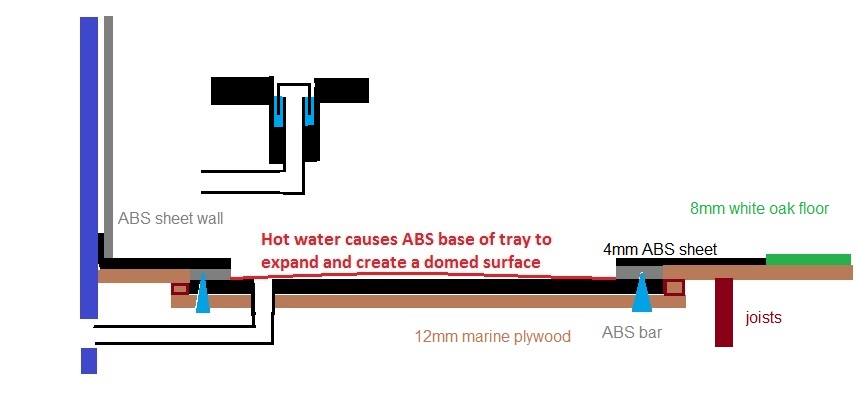

By bespoke fabrication how different was it from a standard shallow shower trap?
This is the original working sketch of the tray and trap. Not to scale. The ABS bar ( grey ) is 30mm thick
The inverted U in the trap has supports to keep it's top level with the surface of the tray.
All the tray is solvent welded. The wall sheets are not welded to the tray due to the problem of the ABS expanding when warmed,
