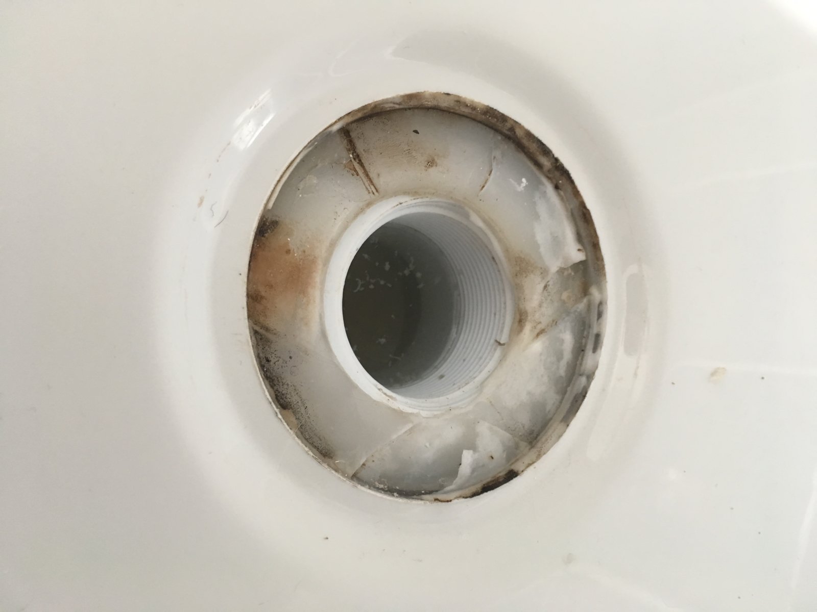

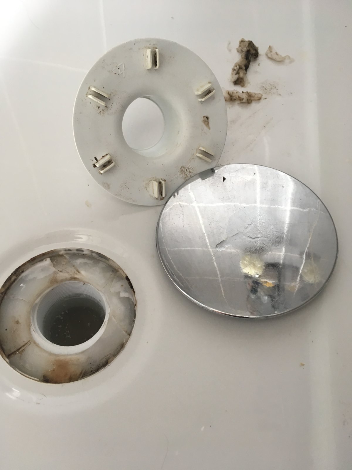

hello our shower waste trap is slow to drain and annoying it doesn’t have a trapto remove and get rid of hair build up.
Even more annoying when I put my fingers down there I can’t feel a hole, so I guess the water rises then overflows into the pipe (if that makes sense)
As I got fed up with it today I decided to undo the top part, and was hoping to then see a part I could of then pulled out but nothing, just the bottom of the trap bouncing on the ceiling below.
I’m thinking two things here either cut into the kitchen ceiling and just remove the old trap, replace with a new trap which has a removable filter then either new plasterboard section or fit an access panel for future times
Or put some silicone back down, screw top part of trap back on and try a hardcore unblocker (saves the kitchen ceiling being hacked up).
Whats the best great quality unblocker? I’ve used some cheapo gel stuff which I think has helped a tiny tiny bit?
Obviously due to the odd design I can’t use any tools at all
as above no chemicals - none at all.

Unfortunately the tray is bang on level with the floor so can't get to it nicely. The water doesn't gurgle just slow to drain and when your in the shower it starts to fill up then when you turn the water off or down then it will drain like 30 seconds later.
Absolutely no idea on where the pipe goes, from what I can tell the bottom of the waste trap has a pipe that goes straight out then I imagine they'll be a 90 degree bend going right and along the ceiling of the kitchen
There's a picture there, also you can see a rubber washer there which has had it, where do I get a new one of them from?
If I decided to just buy a new waste trap I assume I just pull that old washer out and use the supplied ones.
Also just to be sure, the hole is 90mm in diameter (https://www.screwfix.com/p/mcalpine-shower-trap-chrome-effect-90mm/45503) would fit no problem
