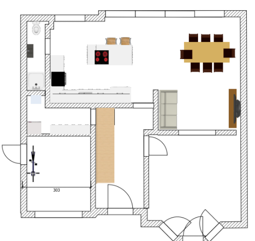

Hi All,
We have recently moved into a new house that has an outside toilet and a larder next to the kitchen. We are thinking of taking out the corner of the garage to open up the kitchen into a large rectangle and then turning the toilet 180 degrees and turning the area into a small wetroom. Currently its 830mm wide with the existing wall, they are non-load baring, so can be removed and made wider space for the wetroom but it would sacrifice kitchen space which is already tight. But was considering making it 1m wide and about 3m in length.
This is what it would look like.
PR,
With that layout (shower at one end and Toilet at other) I would decide by seeing what width of shower tray and shower door you want.
Perhaps try a few out first and see what works for you.
SFK
I have replaced a bath with a shower tray and the width is good at just 700mm. So you would have a roomy tray in that layout. Be careful of an inward opening door, make sure your layout does not cause the arc of the door to clash with either WC or basin.
Thanks, yeah was thinking of going to try out some shower trays.
Blagard, the door would be outward opening for this bathroom, or maybe a sliding door pocket door. thanks

Thanks SFK, some helpful stuff there. I`m wondering whether a wetroom style would work with this, so avoiding a tray and door.
something like this must be around the size we`re looking at?
PR,
Note that I am a DIYer, so only limited experience from couple of bathrooms I have put in.
I have never installed a wet room. You are right that it does make room look bigger which is good. I have always found (from experience at friends and in hotels) that wetrooms look nice, but can be a pain.
Issues (all of which can be overcome) are:
- Need to tank room properly - so might cost more (or might cost less than expensive tray and door).
- Need proper slope into drain (so need good tiler)
- Do you have the drop for the drain (noting that a shower tray gives you a bit of extra height that can be useful).
- Are you happy with everything else in room getting wet (ie wet toilet and wet shaver socket, wet towels, and wet room door). See here from soemone who is trying to address this issue: https://www.diynot.com/diy/threads/...m-without-needing-a-tray.487430/#post-3970212
- How do you stop the water going into kitchen when drain needs unblocking (tray gives 1 or 2cm of warning, floor does not).
Again, wet rooms are great and I think a great solution for you, but above points need considering to make it work well.
SFK
One thing I would say is that whilst a 700 tray is OK its pretty cramped at 700x700 if you go that narrow then think something a long the lines of 700x1200. Would also agree that unless you have loads of space wet rooms are a pain
