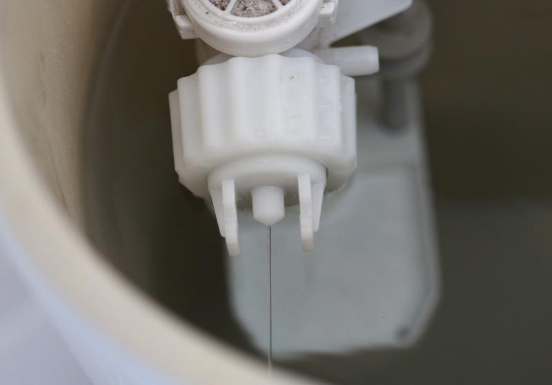

Im a homeowner, not a plummer and I have a Siamp Compact 99B cistern which won't stop filling up.
I have replaced a worn out inlet diaphragm but it hasn't helped.
What I'm confused about with this system is HOW the water is meant to stop.
This is the system....
After a flush water comes out of this hole as shown
but when it reaches the limit this lever arm is meant to cover the hole to stop the flow
What I don't understand is how this lever arm stops the flow if it also has a hole in it. Is there a piece missing? I've looked at the installation guide & tech help on the Siamp website and there is no mention of it.
Can anyone help?
Yes there is a piece missing. The arm should have a little piece of rubber in it, this blocks the hole on the main valve.
All I can suggest, unless you can find the rubber, is to change the valve for a new one.

If you don't fit the new membrain in the correct position then you will have all of these problems.
Looking at the back of the membrain washer there is a locating slot at the back that has to line up with a peg on the main body of the float valve, get it wrong & you will have all of these problems.

Well folks it would be an amazing valve which could affect the diaphragm and close the valve with 2 holes remaining open.
I agree with mogget, there should be a clear silicone pad in the arm which blocks the small hole as the float rises.
I will take a snap before replacing the split diaphragm which brought me here and post later if there are still unbelievers :)
