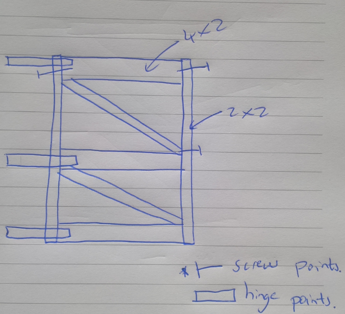

is it okay to use 4x2 and 2x2 treated planed timber to make a frame for the garden gate? I will nail featheredge boards to the face
for garden work, I've recently been using decking timber. It is cheap and pre-treated. I then use a wood preservative such as Cuprinol which includes a water-repellent colour stain. It's more expensive than fence stain, but gates deserve protection. If you apply the preservative before assembly, you can protect all the nooks and crannies.
thanks for the quick response. my 4x2 and 2x2 are also treated. I should also have mentioned that I have some left over from a previous job. Hence, the cost considerations don't apply.
Please advise.
I would appreciate any advice that anyone can provide with the construction of this gate please and whether I can use the treated timber I already have. I had the following in mind by way of constructing the frame. I would then nail featheredge boards to the face.

Thanks, I will reverse the braces.
I will add a capping once the featheredge boards are on.
Am I okay to use the treated planned timber that I have left over from another job for this purpose?
Yes, it should last for a fair number of years.
Try and contruct so the gate has detailing that avoids trapping water.
If you can form a V where the rails and stiles meet instead of a flush joint that would help (hand plane, electric sander would do it, 3mm radius kind of size) -and soak the rail ends in some treatment before assembly

Braces running wrong way - hinge side should be lowest.
The frame should be Mortise and Tenon (best), Mortise on the rails, Tenons on Ledges;
or Lap-Having joints, cut so that the rail lap is on the outside - so that the ledge lap is clamped between the rail and facing boards.
