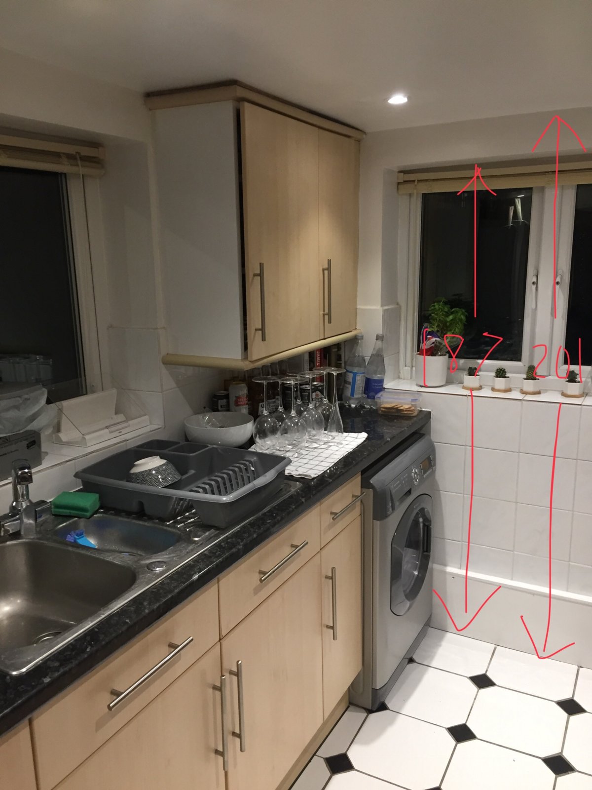

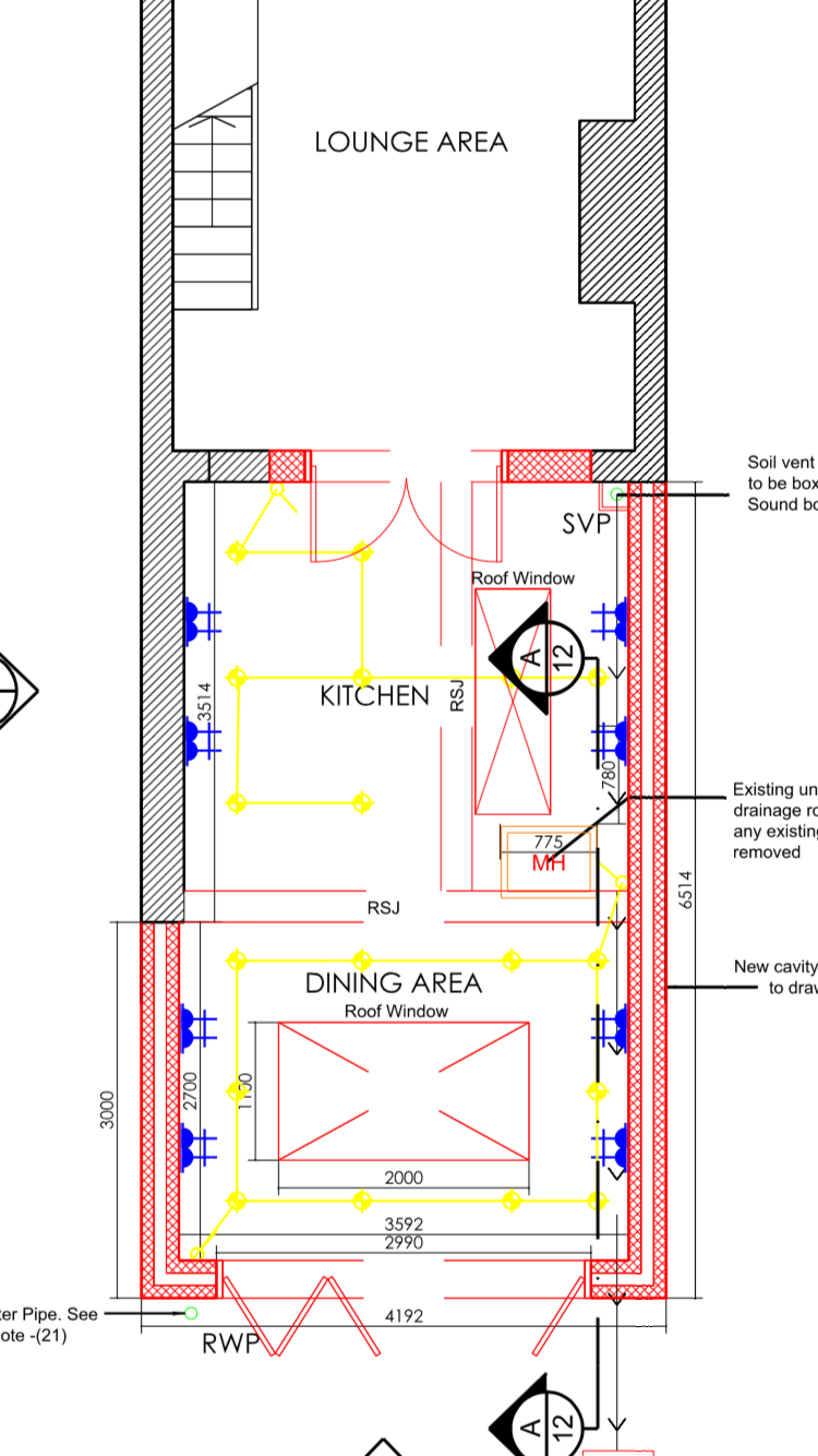

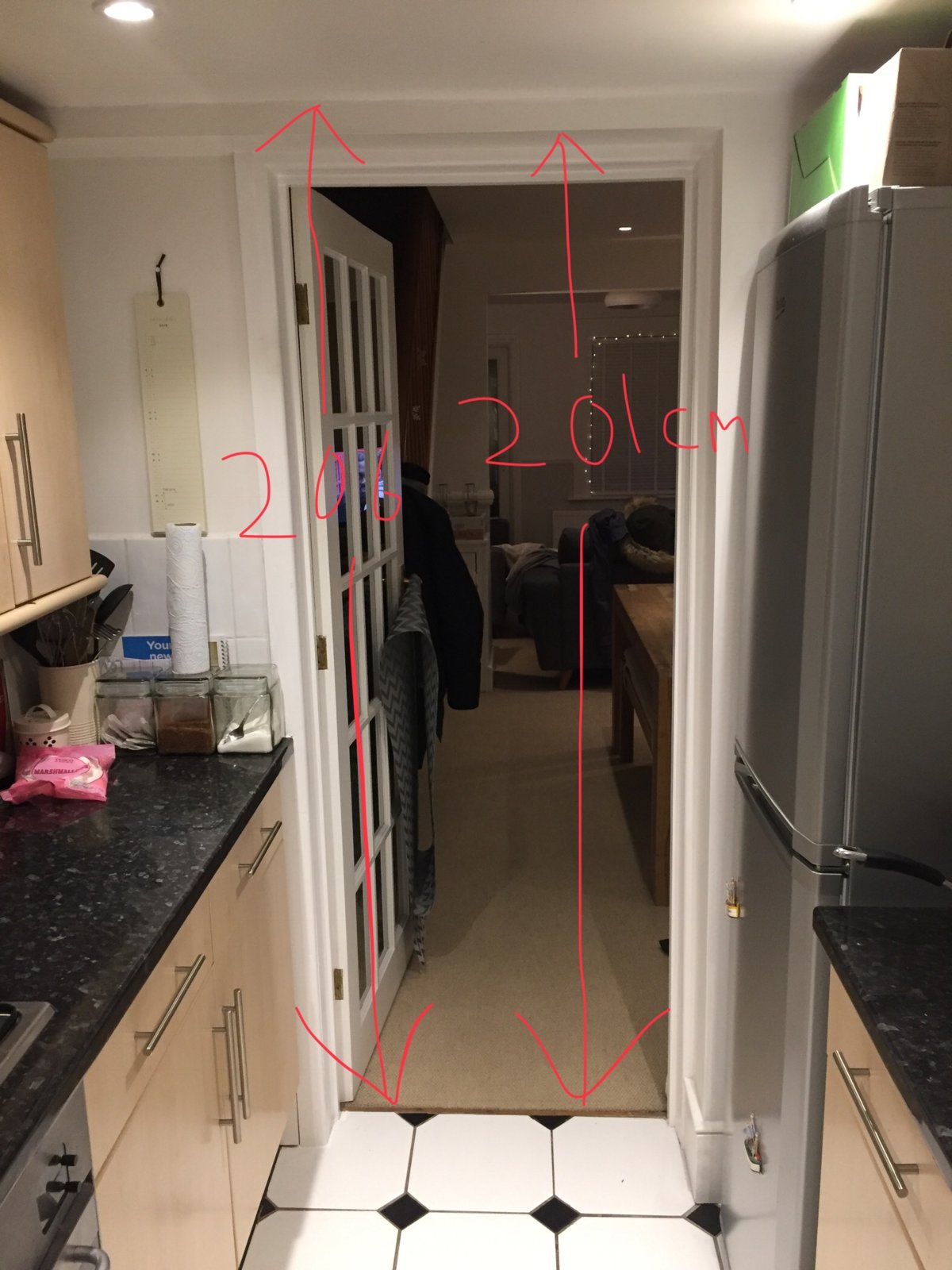

Hi everyone, I have planning and building regs approval for a single storey side return extension. The drawings show the RSJ positions. My concern is that if they simply take the place of the existing lintels above the windows (see photos) there will not be enough head clearance. The ceiling is already quite low. See measurements
Can the RSJs be made to be flush with the current kitchen ceiling height? How difficult is this for a builder?

Your designer should have designed the supports to be within the roof/ceiling. It's not rocket science to design or do it.
I never asked them to. Have overlooked this with my architectural designer. Only just realised.
It can be done but will be more expensive and can cause disruption to the upstairs floors depending on floor depths and joist runs.
You should not really need to have asked, it should be done as standard. Who wants a horrible beam breaking up a flat ceiling?
Steels can be put flush in the ceiling, but it isnt easy.
Depth of steel may be deeper than joist depth -sometimes a UC can be specd instead of a UB.
Until ceilings are opened up its impossible to know what is involved. Pipework, electric cables can be in the way.
Often upstairs flooring will need taking up.
Still better doing all that than spending the rest of your time in the house, banging your head. :)
50% of extensions I see have horrible beam down-stands. Understandable as doing it properly is much more invasive on the house =£££
It's worth doing though, considering how prominent it'll be.
Ours ended up with a compromise, the front to back beam was down stand and the left to right was flush.
This helped with the joists upstairs and the arrangement of beams on the column, so was hopefully the best balance of cost.
Thanks for everyone’s posts. In my case both the front to back and left to right beams will need to be almost flush with ceiling I think because having either at 6ft1 is going to cause bruised heads...
