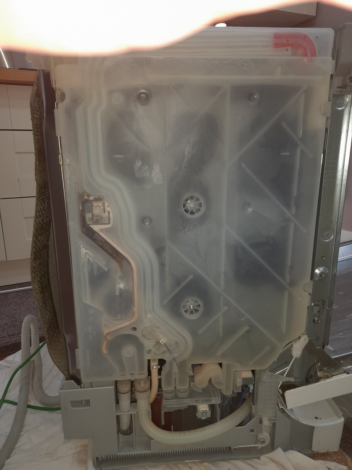

Hi all,
My Siemens dishwasher suffered from E15 error. After switching off/on the drain motor was rotating constantly so after doing the usual checks (filter, drain moter rotating freely, outlet hose, U bend) I pulled it out, rocked it forward and it worked for a while. This process was followed a couple more times until I interrupted the machine mid-cycle one time (by opening the door) whereupon an immediate E23 appeared. I can switch the machine off at the wall to get rid of the E23 code but as soon as I try another cycle the E23 code reappears after a couple of seconds. It appears that he drain pump tries to start up though. At least thats what it sounds like from the outside.
Any ideas?
Update. I've got the LHS off and find this contraption. There seem to be 2 waste hoses at the bottom LHS. One from the drain pump? and the other to the outside.
a) what is this contraption? and
b) can I just pull both hoses off and join them?

Might you have damaged the drain pump seal when attempting the earlier repair, allowing water into the workings of it and the related circuit board that I believe is built in?
Blup
No.
My earlier repairs were conducted without removing any covers.
I have now checked the hose from the pump outlet to the contraption I posted a picture of. It was clear of restrictions but full of water, as I expected.
Do you have any idea what the darkened areas of the picture I posted are? I get the feeling that this is an area where floating oil and grease could be shoved up as the machine empties.
Maybe this needs cleaning out? If so, how?
I'm tempted to by-pass the contraption altogether.
By passed the contraption and same thing happened. Removed the drain pump, found no blockages and the pump moves freely. Decided to buy a new (compatible) pump off ebay and try that. I may be wasting £22 but even the chance of saving the £500+ a new dishwasher would cost has gotta be worth a go.
Thanks Assuhors, Any idea what that discolouration on the LHS of the heat exchanger is and if it might affect the operation of the machine?
As you suspect, the discolouration is grease and gunge from the wash. There's a little moving plunger thing in the rectangular bit at the top. Some of sort of air admittance/vent valve. It's tricky but you can clean it out although it won't outright stop the machine working.

Thanks T&B. I cannot find a vent hole anywhere near that square bit. Is it at the rear of the heat exchanger contraption?
If so, any tips for removing it so as to access the vent hole?
Opps, the waste path from drain motor to the end of the waste hose is clear. The only blockage is as mentioned in the post above.
I guess the vent/plunger is there to release any trapped air no? If blocked, perhaps with air in the system, the drain motor would have to work extra hard to drain the water thus eventually causing premature failure?
Guess I need to clean it out.
All sggestions as to how to do this gratefully recieved.

Tried to follow the steps but couldn't manage without drilling a couple of holes in the heat exchanger to allow me to insert wire/compressed air in to clean out the grease. The grease seems to be cleaning out but the next problem is to effect a watertight seal over the holes I have drilled.
Any ideas?
Success...of a sort.
All the congealed fat is now removed and the same thing happened but then it struck me that when I installed the pump I neglected to reinstall the little white clip that fits where the impellor faces the sump. Replaced that and the 15 min cycle finished. No error codes.
Wot an eejit I am.
As Tea & biscuits said earlier, If I had put the white clip back, the machine would probably have worked!
I now have water coming out of the holes that I drilled in the HE when the drain pump operates so the next job is to patch these holes.
