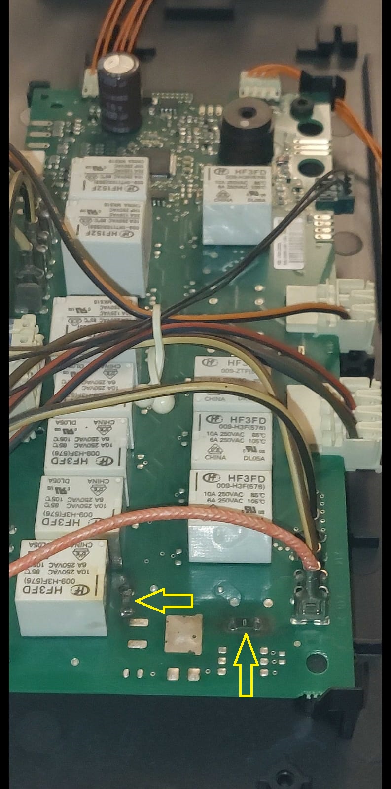

Dear All, I had the same issue with my Siemens oven HG36AB550J /10.
The bulbs didn't work but all other function were ok. My issue happened after the failure of a single bulb, the one on the side of 25W.
After the issue there were no power in may flat, this is a sing of 'short circuit'.
OK, there had been a short circuit but where?
Since the oven was working (excpet the light) I supposed there was a problem on an internal part of the oven, may be a fuse, or a relay.
I looked at the spare parts diagrams (available on the siemens site) and I wasn't able to find any fuse. Then I thougt the broken component could be the 'control board' with code: 00657052 because it is the only component with relays. The price of the board is high and now it also quite difficult to find.
To get inspired about how to disassemble the oven I found this video:
Then I decided to open the oven to see what went wrong. I wasn't completely sure the problem was about a single relay (the one the command the bulbs) because when I opened the door of the oven I was able to ear the 'click' of a relay but, of course, no light. Then I thought the commanding relay was working and the problem should be somewhere else.
Then, on the top of the oven I found a board with many relays ( the command board) and I found 2 problems. There are two burned jumpers (implemented as 0 Ohm resistor). See the picture below - yellow arrows
I replaced that resistors with two wires and now the oven work again. The bulbs make light.
The resistor I replaced were two '0 ohm' resistor. They are a sort of wire the manufactured used to save money in the production process.
But they acted as a fuse that saved the commanding relay. Then I thought I'll must replace at least one wire with a fuse.
As soon as possible I'll replace one of the wire with a fly mount fuse of 1Ampere (250 VAC)
I hope my experience helps.
