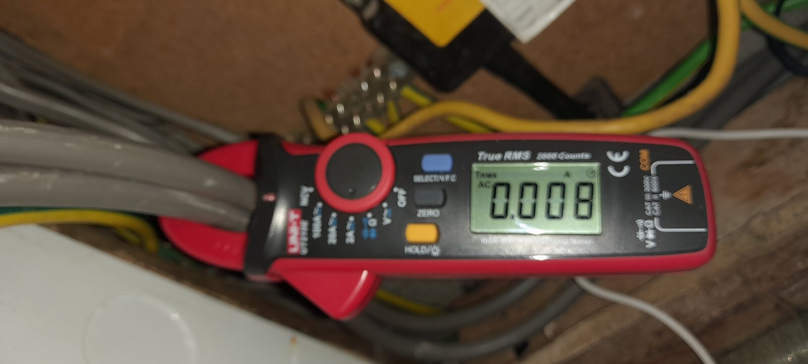

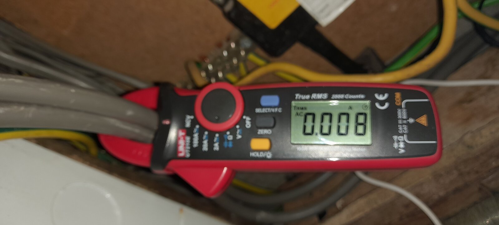

I am lucky, I can measure Diffrence line neutral 8 Feb 24.jpg in the main RCD tripping is not one thing, but a combination, and turning off the power may have allowed some thing to cool, and in doing so it has sucked in moisture. But since most MCB's don't turn the neutral off, to find what is the problem without tools is not easy.

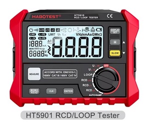

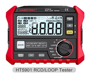

So really no option but get some one with the tools, Loop impedance tester.jpgto test and find out what has gone wrong.
