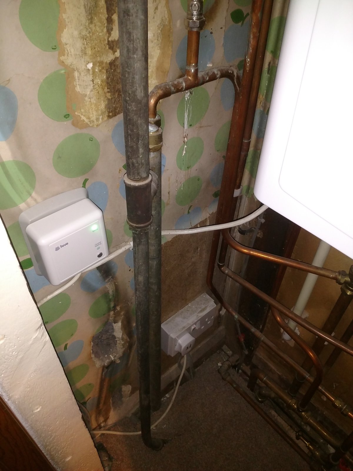

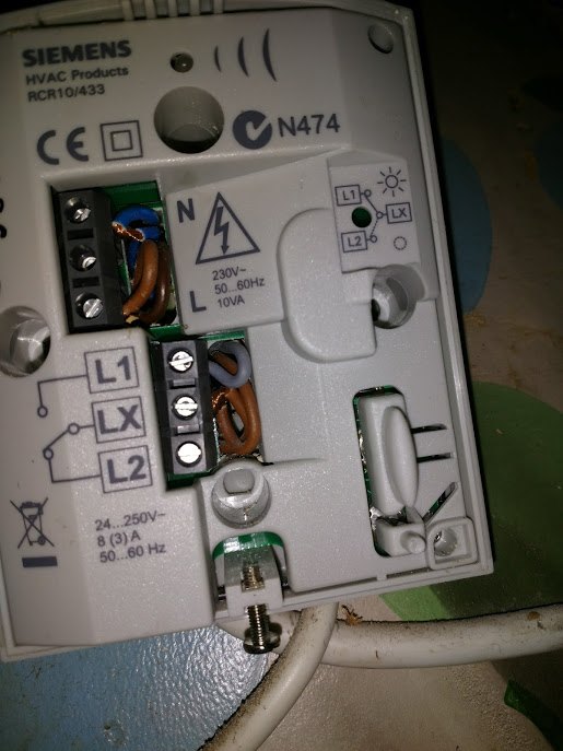

We just moved into a new house that has a Siemens therm installed on a Glow worm combi boiler. It works fine but I find it really complicated to programme so want to switch to a Hive as the prices are down for 'black Friday' sales.
Before I install I just want to doublecheck the wiring as I struggle to get my head around it.

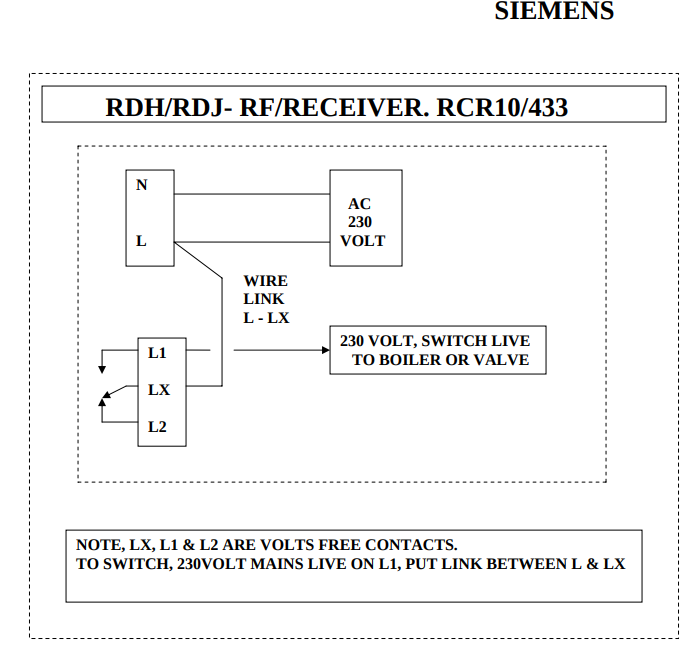

There is a link between L and LX on the Siemens as per this wiring diagram:

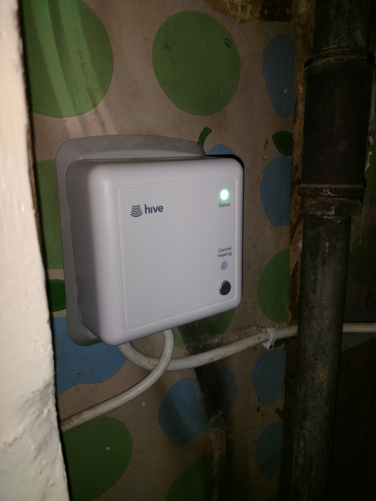

Here is the Hive diagram for reference:
Any help is appreciated!
