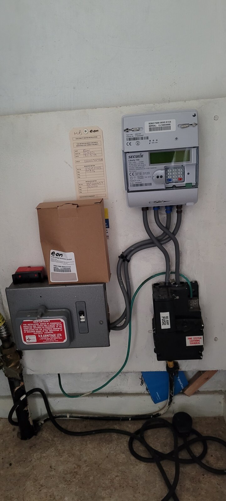

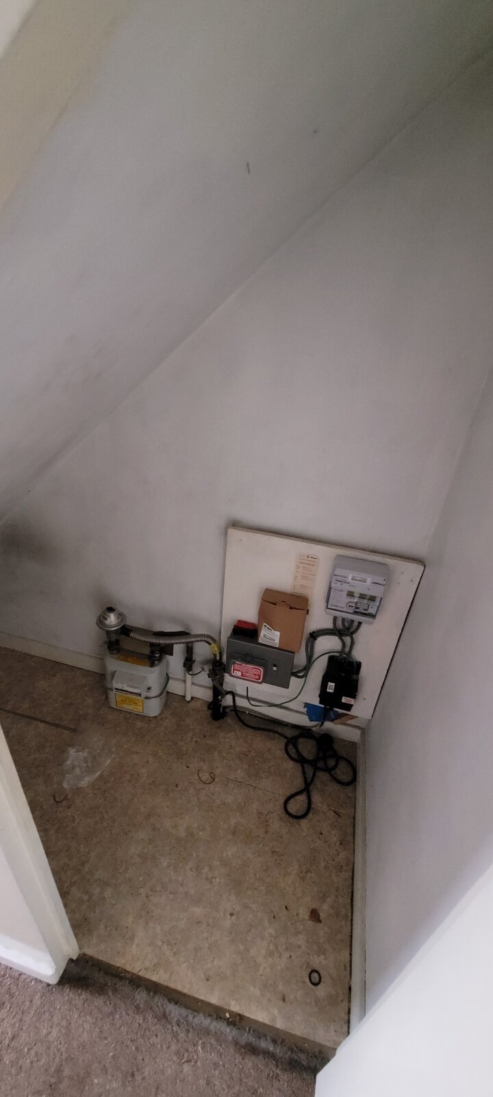

As far as i can understand from what i have looked into, any property that hasnt been rewired within the last 30+ years may require it to be done in order to bring it up to current standards, i didnt get much of a chance to look fully into the electrics as i was too busy looking at the structural side of things and only managed to take a picture of the existing Fuse box / Consumer Unit (shown)
i know that from looking that the meter itself is new since it seems to be a smart meter but i guess the fuse box looks pretty old and that will most likely need replacing to an RCD consumer unit?

There is no absolute requirement that you have to bring an installation up to modern regulations and standards. If it met the standard when it was installed and meets your present requirements.
Having said that, it would be worth having it checked out, to make sure there are no hidden nasties and replacing that old Wylex consumer unit (fuse board) with a modern, up to date unit for your own convenience and additional safety. You will probably find there are not enough sockets to suit modern use anyway, so consider having more installed at the same time.

The consumer unit looks like it might be a five or six way - so probably two lighting circuits (up and down), two ring main circuits (up and down) and an immersion heater. Modern kitchens have greater power demands than before, so nowadays the kitchen normally has it's own separate ring main. Something to consider if you are doing a full kitchen refit.

Unless rewired, you have to consider there may be faults unseen with any inspection, and fitting an RCD means they may trip. So better using RCBO's then if a circuit trips, only that circuit affected. And with only 4 fuses/MCB's/RCBO's the cost difference is very little. Other consideration is will there be an electric car? if so a larger consumer unit may be required to take the extra RCD and MCB or RCBO for that, it could need 5 slots, or 1 slot depending on charge point, but having a consumer unit with room for expansion makes sense.

It looks as if it should well postdate that, but we only have the consumer unit as a clue so far.

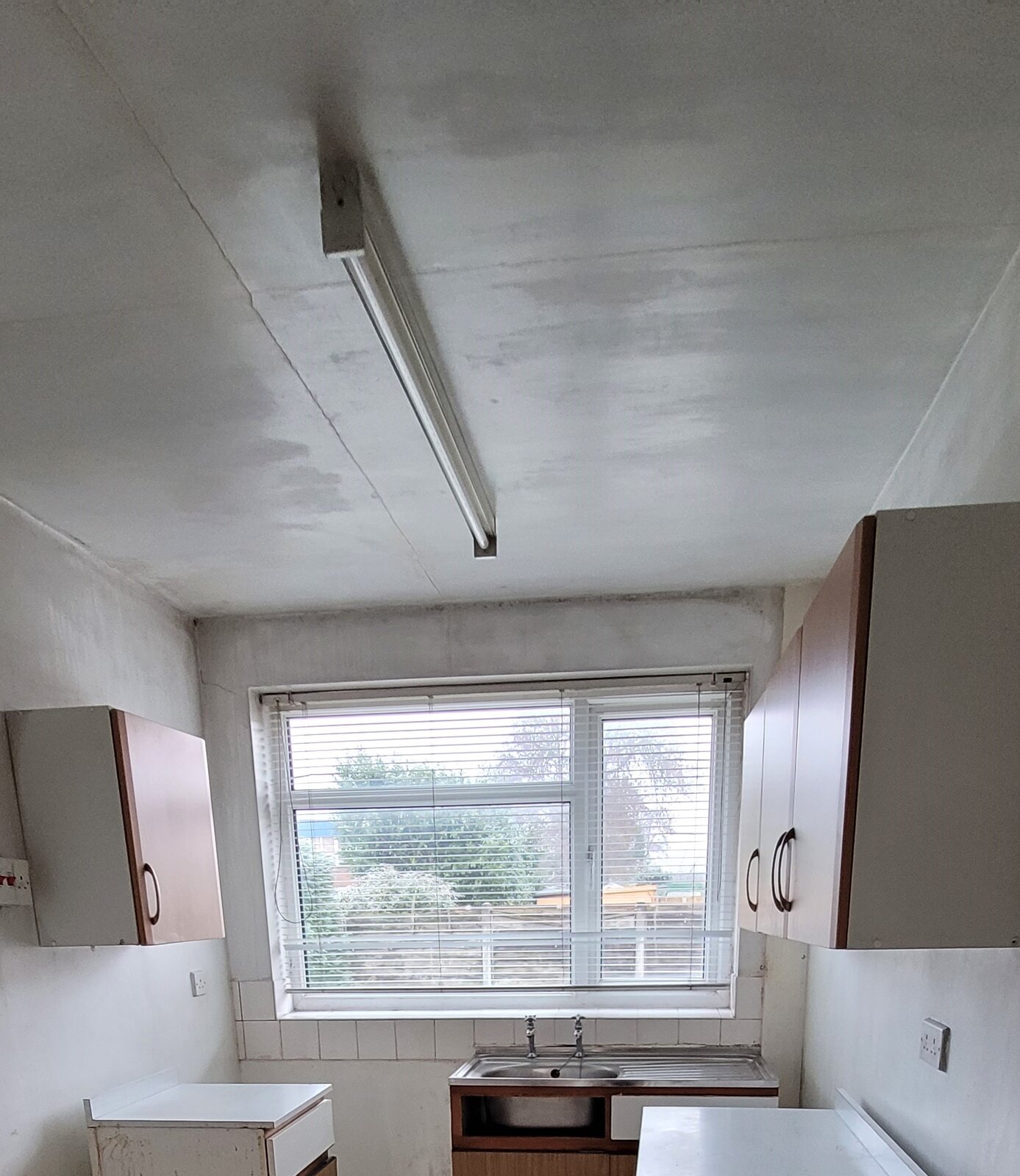

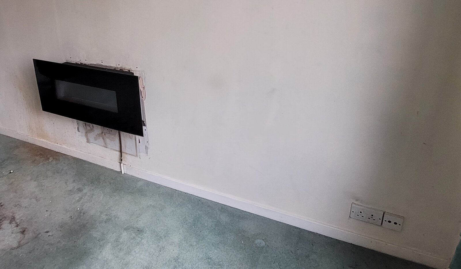

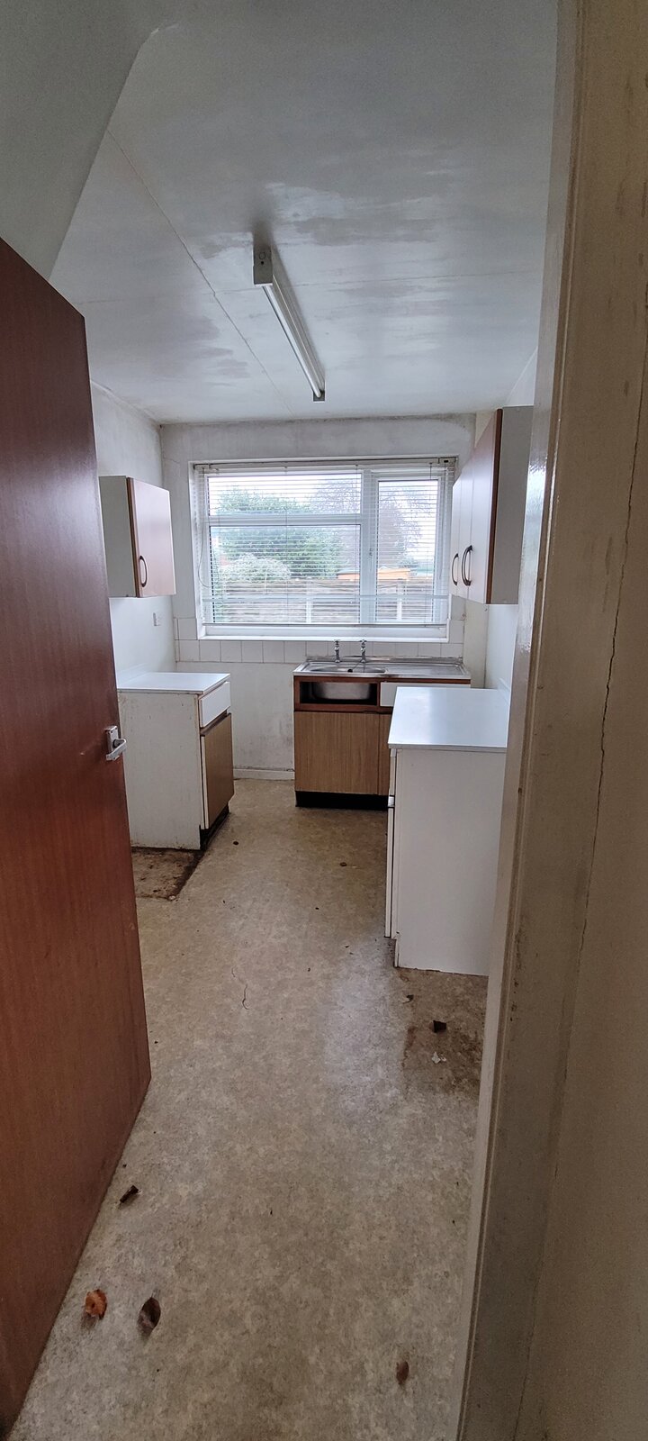

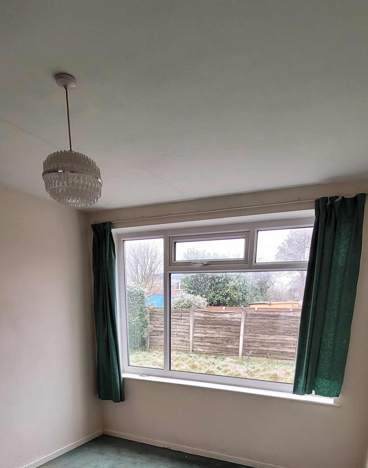

OP - any chance of more photos of the rest of the installation please? Sockets switches, lighting drops?
Unfortunately i didnt think to take a picture of anything in specific, moreso just the rooms themselves but i'm hoping that maybe these might give some clues?
as you can tell there is alot needed to be done with the house and hence why we are trying to stick to a decent budget in order to ensure that we dont come across too many issues along the way lol
Thanks again for all your help guys, much appreciated
I would suggest, from those photos if they are representative, 1970 to 1980. Lighting circuit should have earths and be green sleeved. The only serious concern would be if aluminium cables have been used, but unlikely.
I just checked the Title register which says that the property was built in 1974, if it hasn't had any work done since then i would assume that would roughly be the standards that it was at during that time.
