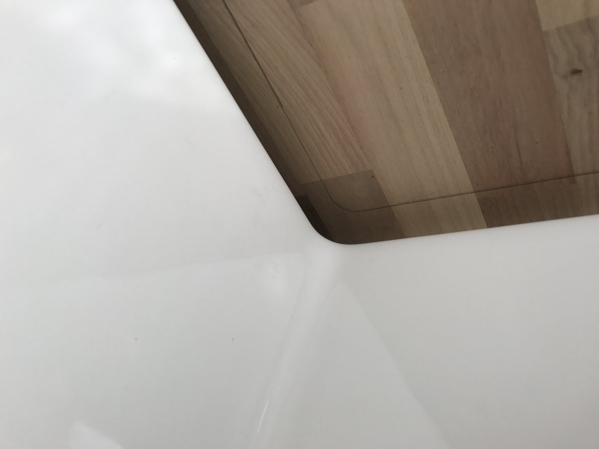

Do I silicone this gap or is there a strip I can stick to the sink that will seal under the weight of the worktop?
I was thinking if there was some sort of strip it would mean I could remove the worktop if I ever needed to.
Cheers
Ok cheers, I will silicone it and probably never need to move it.
Now Bosswhite has brought up an interesting conundrum. It's a hardwood worktop, so should be sealed on all sides (absolutely everywhere) and then stainless steel screws in a sliding plate to secure it to the worktops, so with a belfasts sink (which I've never done before) would you also varnish the sides of the worktop by the sink as well, or take the danish or osmo oil down inside the sink cutout.
My missus has oiled all the sides and the bottom.

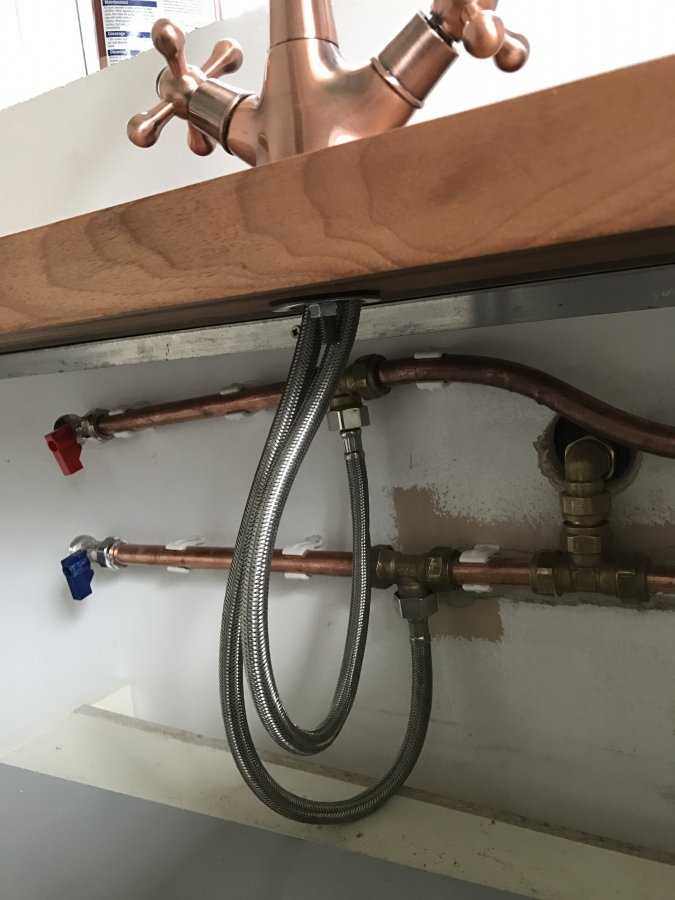

I've put a metal angle round the sides but didn't think about stainless screws, it that so they don't corrode from the moisture of the wood?
There is an expansion gap, I never allowed for it though, I'm just bad a cutting ;)
I just read your link. I'll make the holes for fixing to the worktop bigger and use some washers.
I got my missus to check my pencil line before I cut the hole for the sink :p
Would you use a white or clear silicone round the sink?
Personal preference Ian, but whilst white will blend into the sink, it'll also go grubbier quicker. Unless someone can give you a top quality sealant that won't do that of course.
