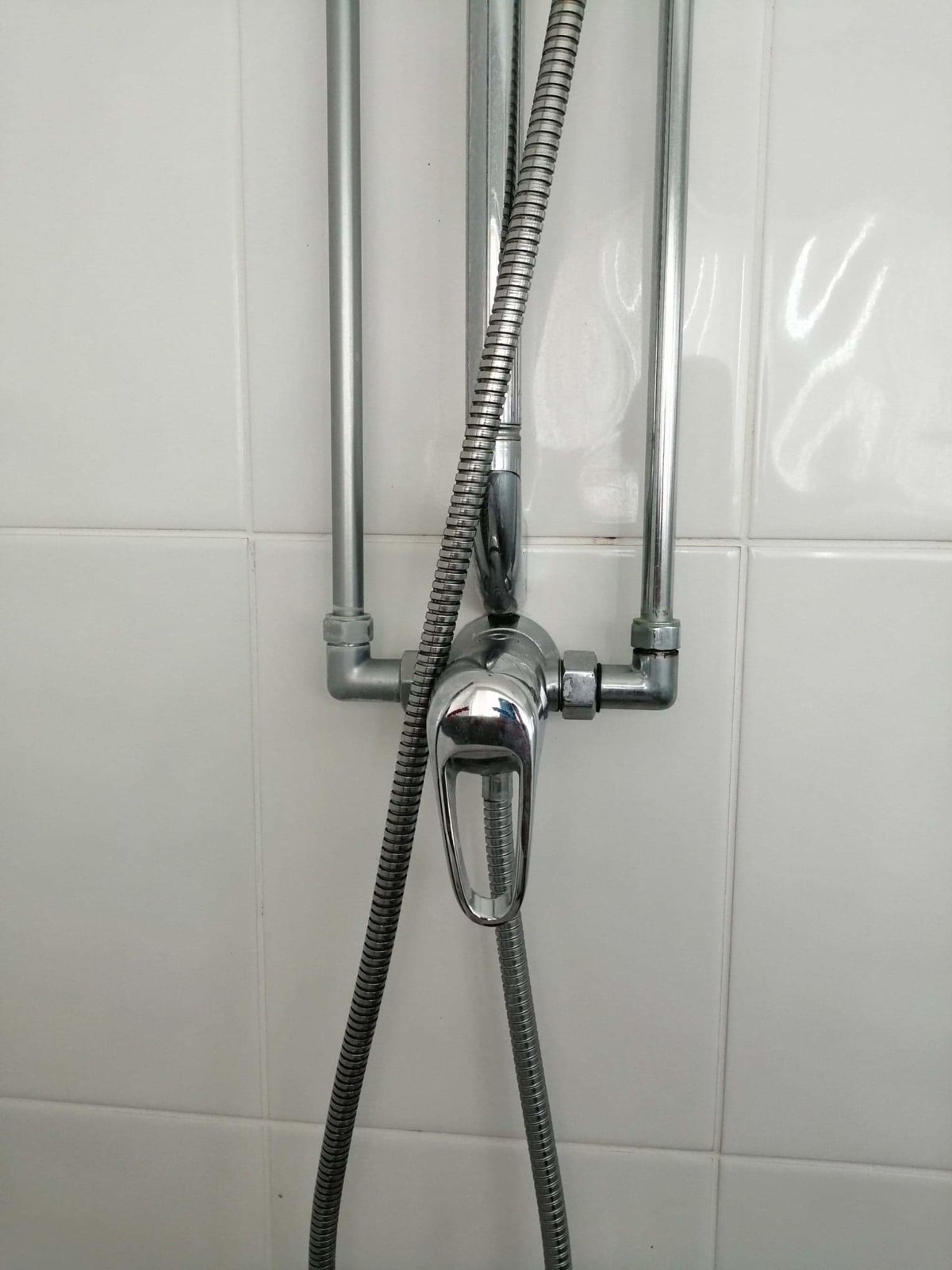

Hi there, i am looking to fit a thermostatic shower valve with the sime boiler to replace a troublesome mixer shower valve. The new valve requires a fully modulating boiler. Do I have one?
Ian, thank you for my reply. I have just moved into the house, i think it has a standard mixer shower which is a nightmare to achieve a stable temp. Any slight movement on the handle and it goes from hot to cold and vice versa. The taps seem fine so I assume the boiler is o. K. Do you think this valve is likely to be faulty and a thermistatic is the answer. I have ordered a cooke and lewis lunda one in screwfix clearance for 50.00 as money is tight. Thanks again...
It shouldnt do that but cant say with any certainty what is causing it , do you have sink with a hot tap in the same room as your sime boiler ?
the mixer might have been fitted upside down. Post a photo of it and tell us if the incoming hot pipe is on the left or the right.
The boiler is in a bedroom hence theres no hot tap in the same room. Im going to fit the thermostatic one tonight so will check the hot is on the correct side. Thank you.
Thank you guys for your help. I changed it last night, hot was on the left, it worked perfect as well.
