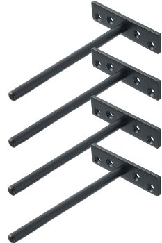

Basically they are simple, thick shelves, so not really very complex. If your shelves are mounted onto steel "pegs" (or floating shelf fittings) like these
they should be strong enough to take the weight of a modern TV providing you get a good fix into the masonry and the shelf isn't too deep (those fixings are 150mm long, so should carry shelves up to about 225mm deep)

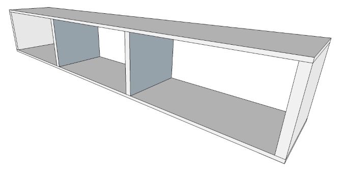

Yes - I think I can do the shelves but it's the cupboards that concern me.
Building a full cabinet, with the correct joins - without skills to use a router - puts me off...but can't afford the £1000s I've been quoted.
They are nothing that requires fancy joins, little more than kitchen units in a row.You can replicate with mdf ( painted) and either make up doors with painted mdf or buy kitchen doors online ( can be made to measure ) in just about any style or finish .
All you need to understand is that a cabinet is basically just a box: top, bottom, two ends and a back. Everything else like shelves, dividers and doors is just an extra.
In order to make a box you need some way to cut material accurately (or just buy-in cut to size material), a flat and level assembly surface to build your cabinet on (this is very important - but can be as simple as an old flush door supported on a pair of trestles or even concrete blocks) and you need some form of joining, the simplest method being butt jointing and carcass screws.
So in reality at a basic level not much kit at all
