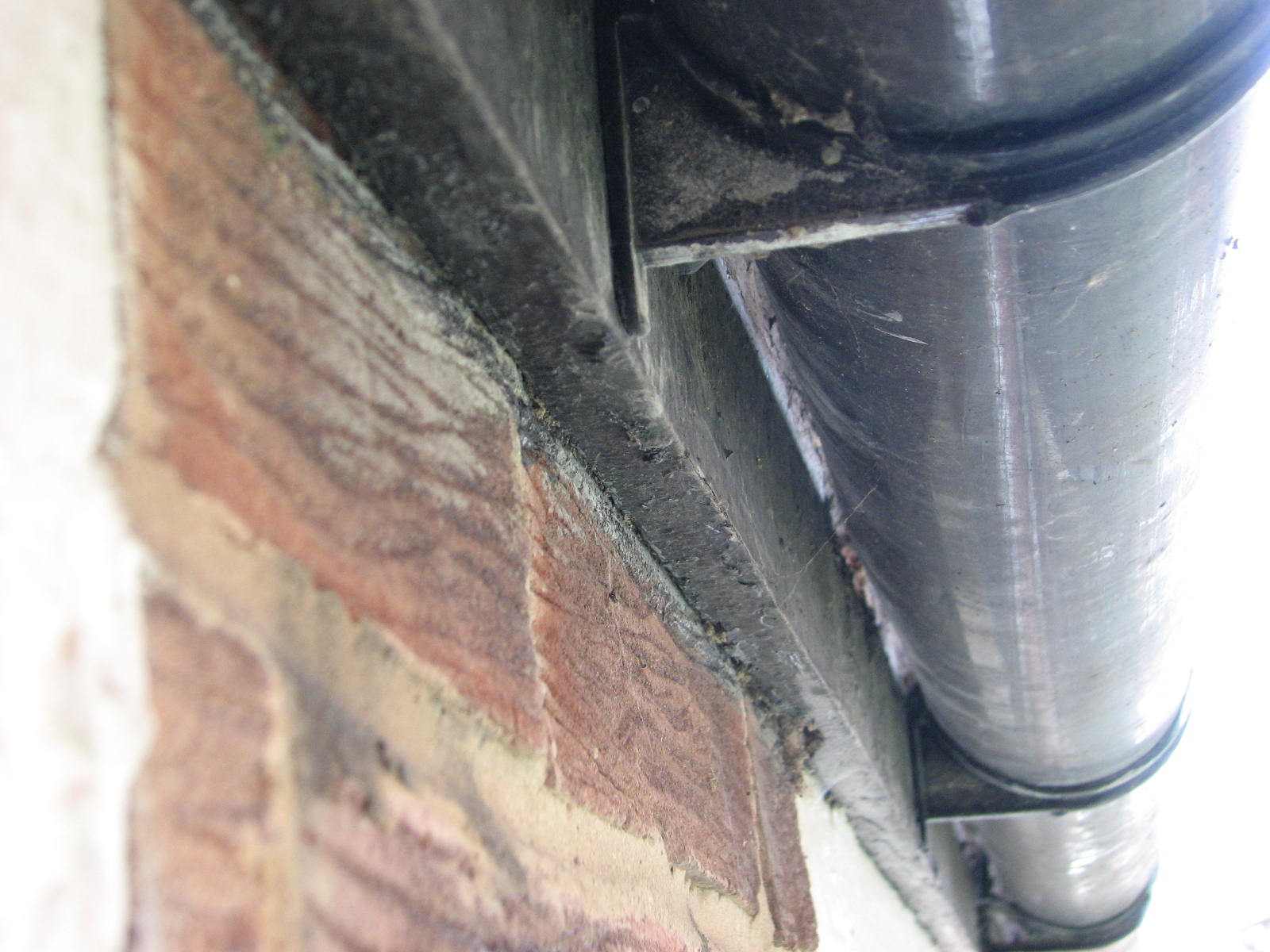

I'm hoping to renew the old gutters and partially rotten wooden fascia board on the side of my garage.
Here is a (not very good) picture

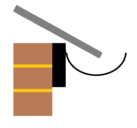

But here is a cross-section diagram which shows better what's currently going on.
The wooden fascia board is 100mm deep, 20mm thick , 4500mm long, plugged and screwed directly into the bricks. The gutter brackets are then screwed into the wooden fascia board.
Ideally I would like to renew the fascia board in black uPVC, but I cannot for the life of me find anything suitable.
The smallest fascia boards and fascia capping boards I can find are 150mm deep and all have that lip bit at the bottom that protrudes out about 30mm that's intended to support a soffit board, but my garage doesn't have a soffit and the 30mm deep lip is too deep for my only 20mm thick fascia board.
Ideally I just need a simple 100mm deep, 20mm thick, 4500mm long plank of black uPVC. Does such a thing exist? If it does where can I buy it?
Thanks in advance
You would buy the 150mm with the 30mm lip and simply cut it to fit. It will cut very easily with a hand saw or even several scores with a sharp Stanley knife. Just keep it all well supported while you cut it to avoid breakages and get help fitting it as that is a fair length to be struggling with solo.
