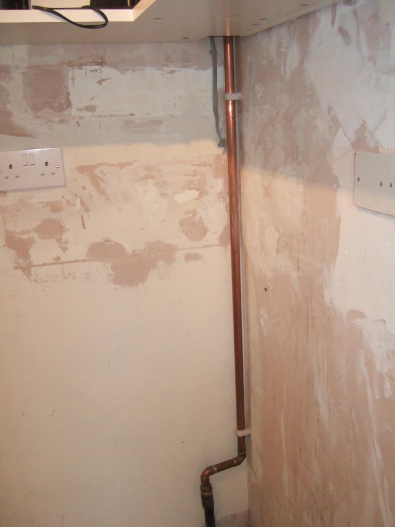

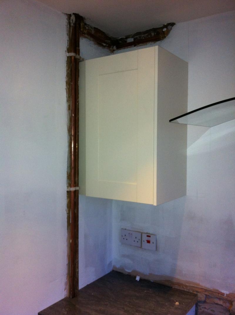

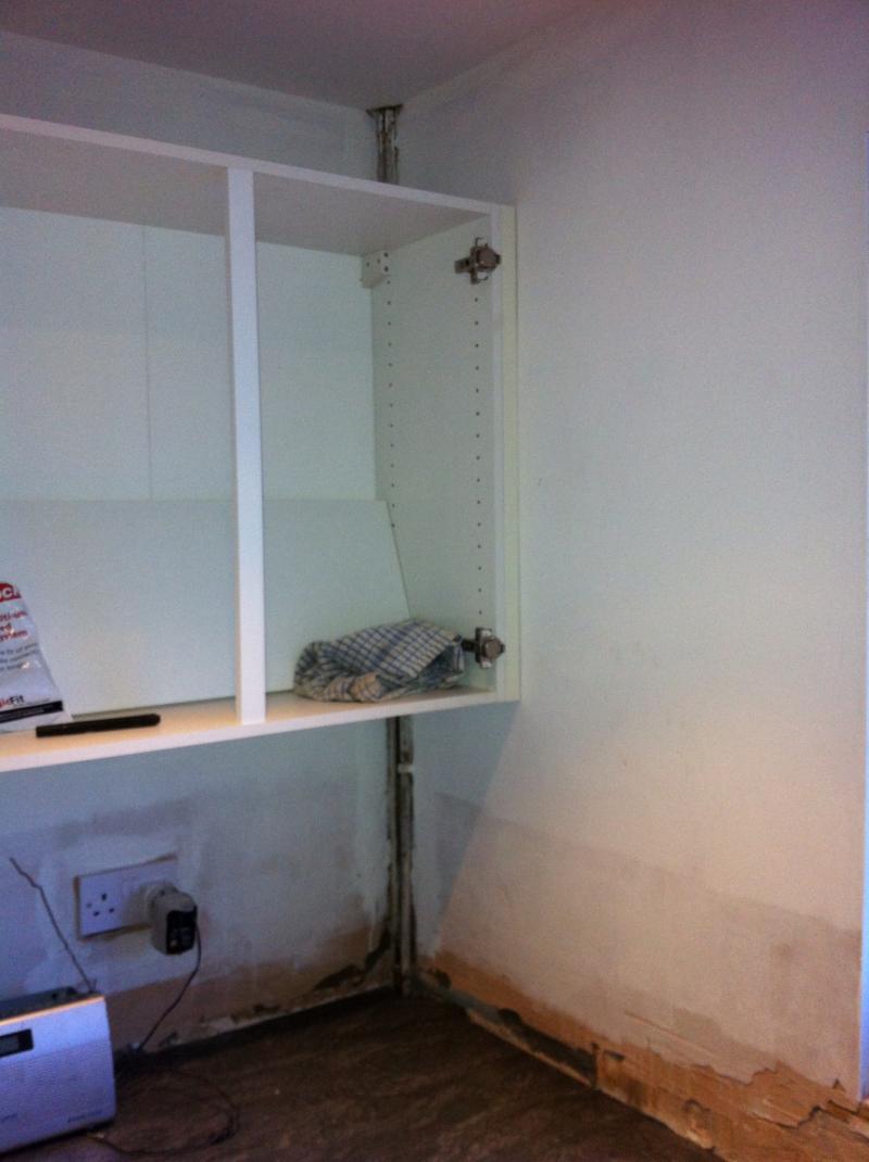

A couple of pics to help -
The 22mm pipes are probably the most unsightly, but as one of them was gas, I chose to leave that pair.
For where I am now, looking for advice on best materials, thickness etc to box them with.
Would go with 18mdf,[no framework needed] the 22mm pipe, I would bring forward the boxing and run it full depth back to wall so cup'd sits next to a 'false wall'.
You would need to relocate socket to the right or move it into the Boxing.

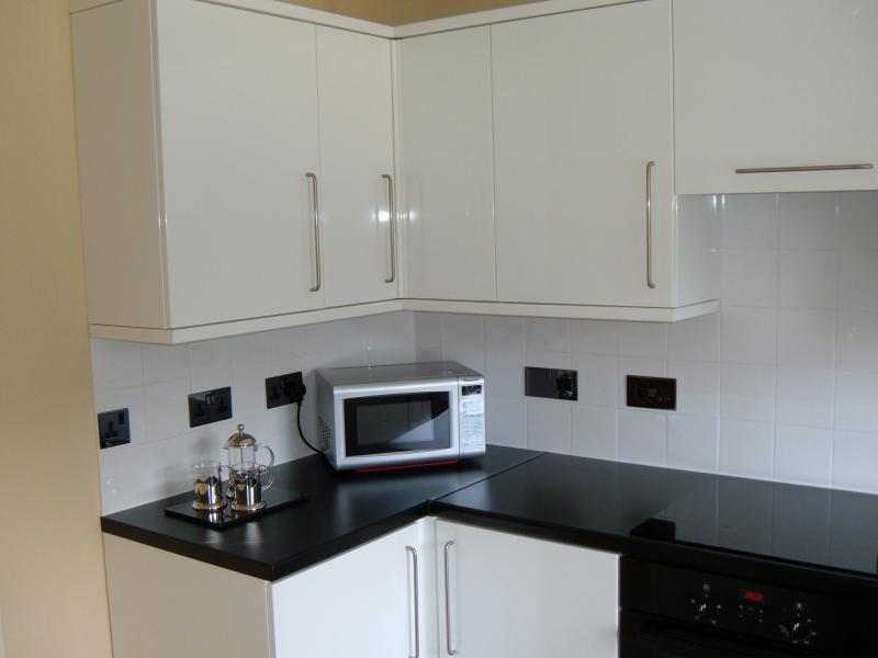

For the corner one just fix a piece of 9mm ply across the corner at 45% with building adhesive, plan it so it will be a tile wide then just tile over the lower and paint the piece above the units. Hopefully here is a picture one I made earlier as Blue Peter would say!
The pipe in the pictures is gas so I allowed ventilation under the units and a couple of vent holes just above the cupboard out of the sight line to give required ventilation.
Ok I know it was overkill but I also screwed a metal plate (a bit of the old boiler side case trim) to the back of the ply to give some protection against somebody screwing a cup hook or similar straight through and into the gas pipe. They have got to be pretty thick to keep on drilling once they hit metal!
