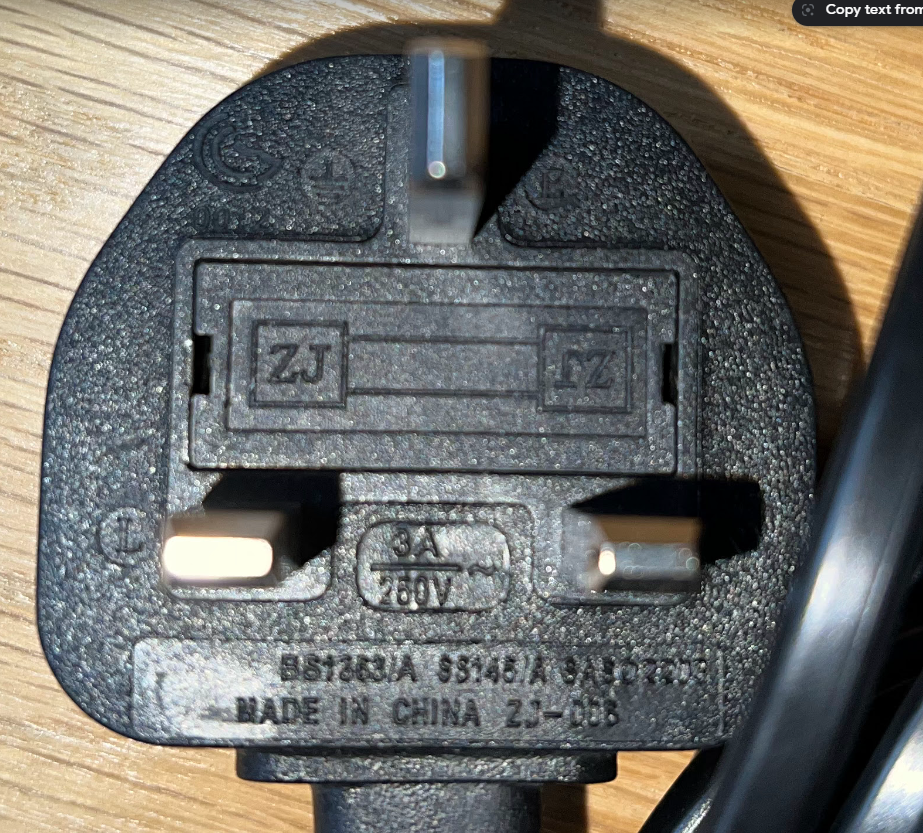

Hiya, hope this is ok to ask this here...
I recently purchased what was listed as a 13a plug, with a 3a fuse (C7 2 pin power cable). On the plug itself its stamped 3a/250a (in a circle). I was planning to drop in a 5a fuse (what the supplied PS5 power cable has) but that stamping on the plug has got me concerned.
Is that stamping an indicator of what the cable/plug can handle and its mis-sold, or just what fuse is supplied? The cable itself is stamped 2 x 0.75mm
The stamping on a connector is an indicator of what the connector is rated to handle.
To determine the rating of the complete cord set, you have to look at the rating of all of the components (plug, cable and appliance connector) and take the lowest.
and its mis-sold
The problem is the term "13A plug" is ambiguous, the literal interpretation would be a plug rated at 13A, but colloquially the term is used to reffer to BS1363 plugs in general.
To the best of my knowledge rewirable BS1363 plugs always have a rating of 13A, but non-rewirable ones may be lower.
C7 connectors are only supposed to be rated at 2.5A anyway under IEC standards (though apparently they can be rated higher under north american standards). So using a 3A rated BS1363 non-rewirable plug as part of a C7 cord set is perfectly reasonable.

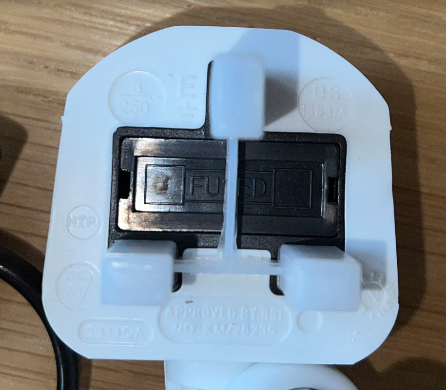

Well, if you believe the marking then at this point I have 3 cables, all stamped BS1363.... the PS5 one, which has 5a/250v on it and two others which have 3a/250v. All have BS1363 on. Really confusing.
If the C7 connector is only rated to 2.5a anyway then that explains why I've been having trouble finding a 5a or above one All I need is 1m extra for it to reach, I should have just bought an extension!
All I wish is to make sure whatever I do is safe, if it should be ok on a 3a fuse I'll leave that in I was just trying to match what Sony supplied without tripping fuses or burning the house down.

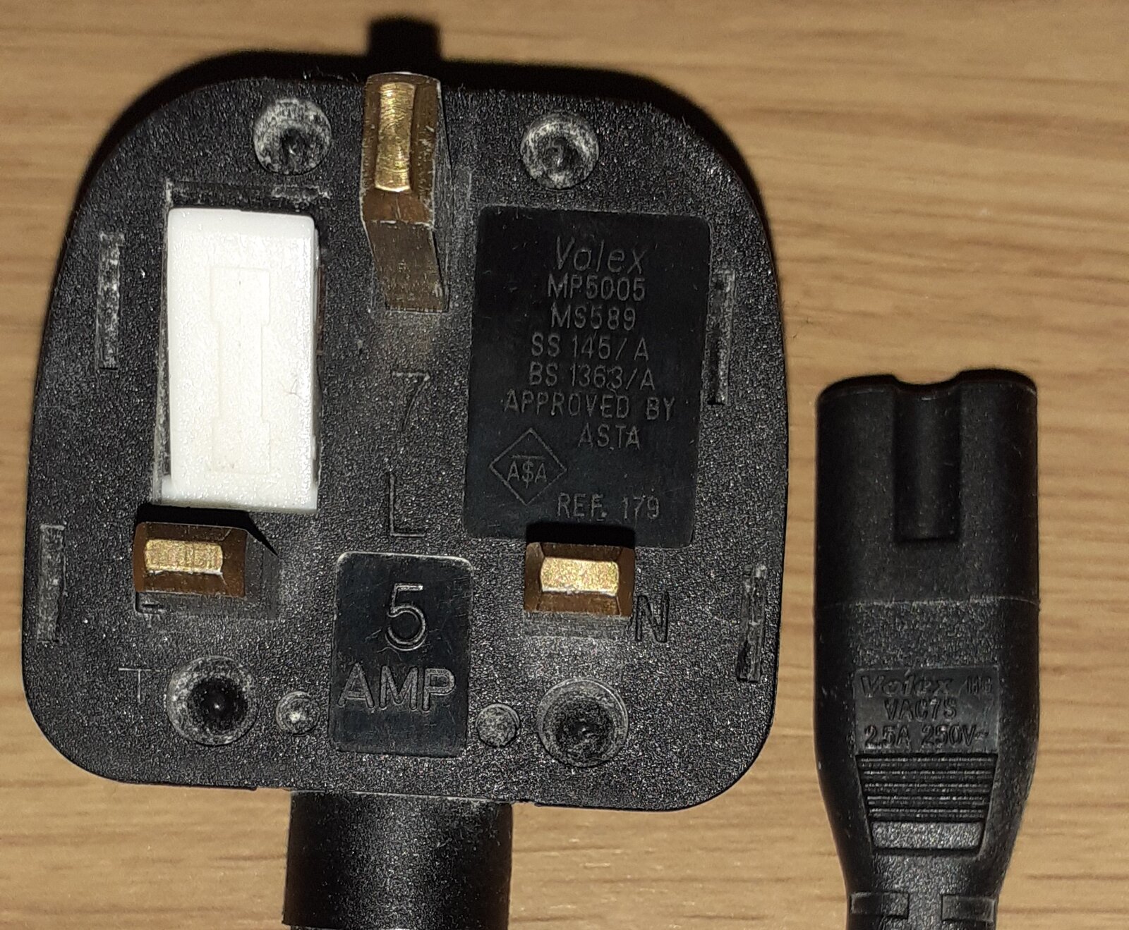

Only on fully moulded plugs/leads:
Just a random example! 5A marked on plug, 2.5A marked on connector and 0.75mm2 embossed on the lead.
If you have a PC with an 'IEC' lead, the plug on it will nearly always be marked as 5A, and the connector 10A :)

gah just checked the connector on the PS5 shipped one, 2.5a for the C7 Didn't think it had anything stamped on it.
Why would you fit a 5a fuse when one of the connectors is only rated to 2.5a? Isn't that a risk in itself?

Only on fully moulded plugs/leads: .... Just a random example! 5A marked on plug, 2.5A marked on connector and 0.75mm2 embossed on the lead. ... If you have a PC with an 'IEC' lead, the plug on it will nearly always be marked as 5A, and the connector 10A :)
Fair enough - I can't have been paying enough attention. I suppose it would not be unreasonable to have such a marking on the plug (of a lead with plugs/connectors moulded onto both ends) if it represent the 'rating' of the assembly (plug+lead+connector) ass a whole- but then it presumably would have to be the lowest rating of any component of the assembly (2.5A in the example you cite).
