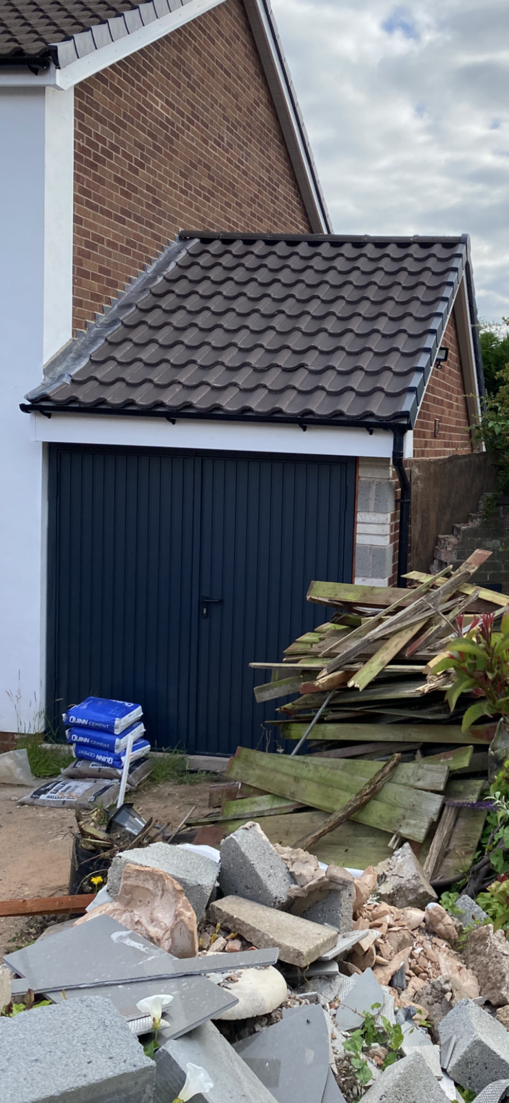

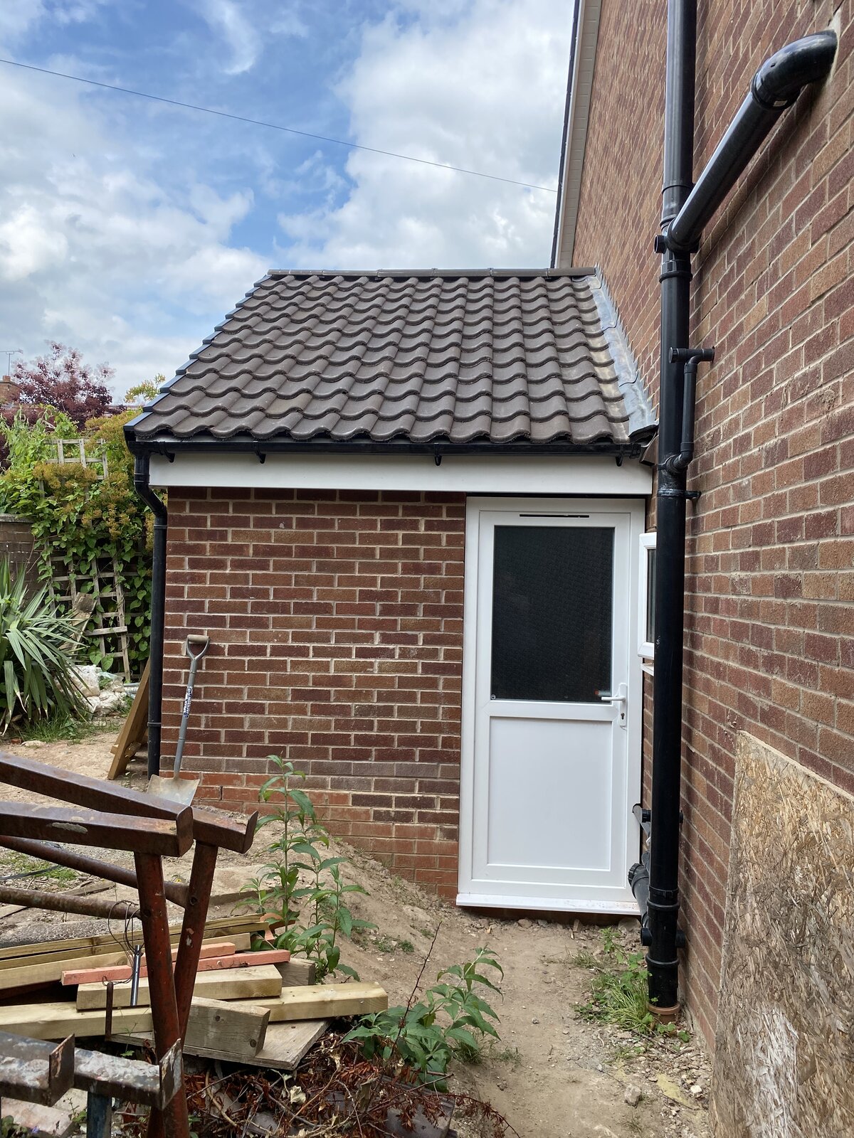

10k ish. I’ve just finished one at mine and materials totalled a shade under 5k including a grand for a door. Mine was solid double skin tho. My material cost doesn’t include foundations as I did them previously as part of a bigger extension
@23vc thanks - would you be able to share a photo or two so I can see what you got for the money?
What dimensions was it?
About 5m x 2.4m

Thanks. Its about what I would want but £10k is alot isn't it. The house I'm looking at buying is only £130k. Nearly 10% of the cost to build a what is essentially a small box out of brick.
