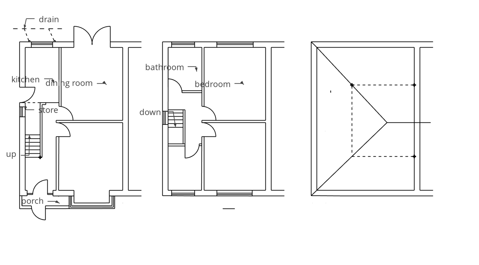

I've had a go at doing some drawings.
Still doing floor plan. I've done existing and proposed drawings of exterior. Will do same for interior.
Most likely going for front dormer so will need to submit planning.
Would I need to add notes explaining what materials will be used, joist size and structural calculations, electrics, etc.

If you need to ask which notes to put on drawings you won't be able to do bldg. regs drawings. You don't need joist sizes , structural info ,electrics on planning drawings but you should specify external materials.

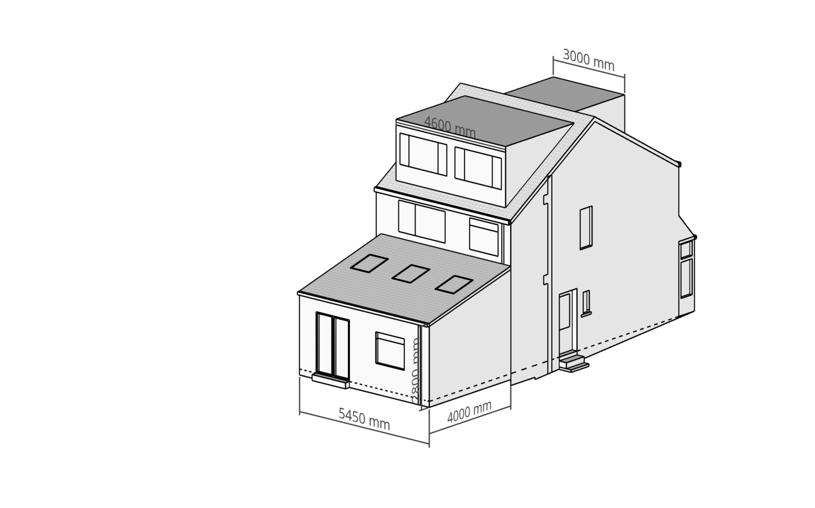

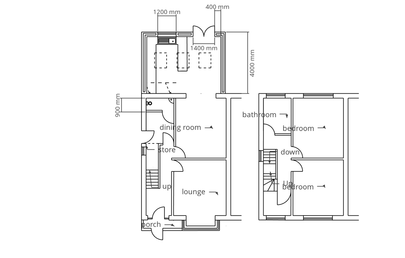

Over the last week i have made an attempt at some drawings for extension and dormer.
What do you think?
The rear dormer i'm undecided to go to rear wall. Would it be a problem afterwards?
Also the rear extension i may use 2 sky windows again would it be issue later?
What else would i need to add in order to pass building control?
Any input appreciated

not being funny but you need all the construction notes and drawings showing the construction that are required to comply with bldg. regs .It isn't possible to go through everything on here. You need somebody to develop your preliminary drawings into proper architectural bldg. reg drawings.

Just submit drawings in the first place how you intend building it if you get planning permission. Very briefly , drawings should show existing and proposed plans and elevations and existing and proposed external materials. Your local planning authority should have information on what you need to submit with your planning application. Can't go into everything on here.

Drawings look ok as design concepts. Just be sure that it all works out when you come to detailing, and that things will actually fit in and can be built ... that 203 beam seems a bit small in context with the roof timbers, and those roof lights seem a bit close the the gable walls.
Thank you. Woody are you talking about roof lights on kitchen roof or the one next to front dormer? What minimum distance is acceptable away from gable wall?
I've seen the beam used on another plan of similar house.
Will up it to 203 133 UB 30.
Ridge is approx 5.8 metres and rafters will be 6x2 (current ones are 3x2)
Floor joists in dormer will be 7x2.(currently 3x2)
Cheers
You need to allow for a double rafter, and also allow for the flashing kit, top gutter and bottom apron, and possibly a tile cover - see the roof light maker's guidance for dimensions and allowances.
For the beam, I wad not referring to its load bearing performance, but that it looked small in context of the roof timbers next to it. If it is drawn to scale then that's fine, but if it's drawn smaller than it really would be, then there could be problems in how those two roofs meet and the rafters fitting over the beam, or the beam needing to be installed lower and below the ceiling.
