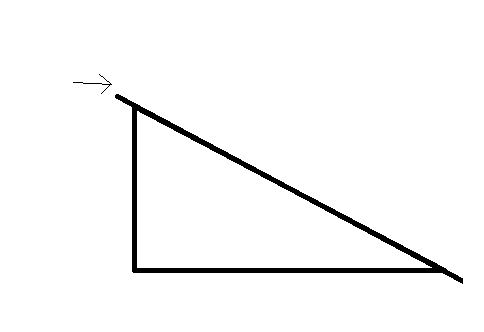

Hey Guys,
Im just about to tile a small outhouse roof, it is a single slope roof (not sure if thats the correct terminology)
So Im good with the breathable felt and spacing battens etc but once the roof tiles are on, its finishing it off was my question.
On the sides Ill use undercloak and cement the sides in. But at the top, what do I do to stop water coming in from the top?? Just cement the top? (ie whack cement under the top course of tiles)
Any help would be grand (attached a rough pic if I didn't explain it clearly)
thanks alot

Mono ridge tiles for the ridge, and do your edges with dry verge. You can buy individual dry verge to suit your tile style, or use a continuous length.
Thanks Alan - never heard of mono ridge tiles, Ill have a look out for that.
Thanks for the dry verge tip aswell - appreciate your time!
