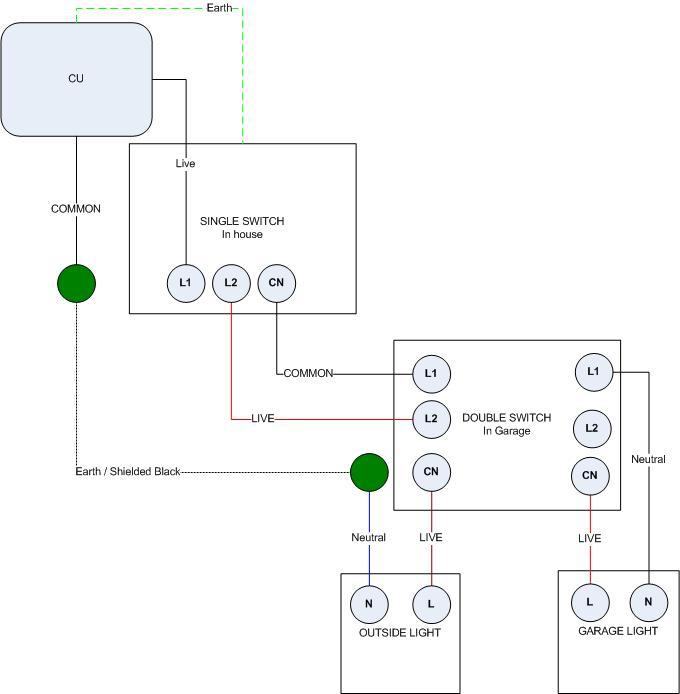

I am having some issues with wiring. A friend replaced a switch in my house with a new one and unfortunately I no longer seem to have a working system. He said it wasn't working but just assumed my bulbs had blown. After replacing the bulbs....I still have no garage or outside lights.
The switch controls an outside light, it receives power direct from the CU before forwarding current to another double switch located elsewhere. The double switch located elsewhere switches on/off a garage light and the outside light.
What should happen is - (a) Single switch turns on/off outside light, (b) Double switch turns on/off garage light and turns on/off outside light.
Unfortunately, no matter what combination i use to wire up the new light circuit, I no longer have a working garage light nor outside light using either the double switch or the new single switch
Can somebody help me. I have not touched the double switch at all.

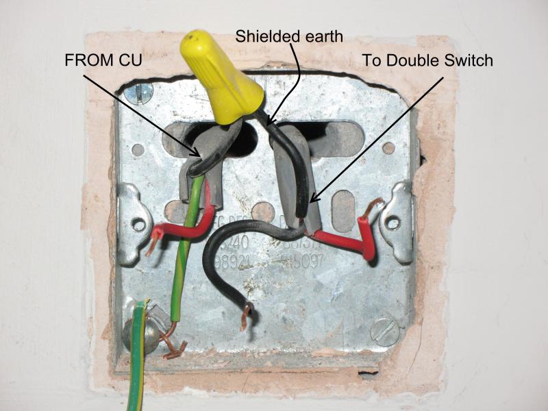

I have a wiring diagram, although the single switch wiring is show incorrectly, i did not want to just show hanging connections. The crimped "commons" were done previously and are not my doing.
I am assuming (obviously wrongly) that i need to wire L1, L2 and CN as i need a 2 way switch. I used this as my guide http://2wayswitch.com/2-way-switch-wiring-diagram/

>> The installation is a dangerous lash up.
I don't disagree it is a mess.
>>It could never have worked as your description - your missing a wire.
My wiring diagram could be incorrect, but the pictures should be correct. It used to work though; what wire do you think i am missing? - I can go and take a look. Which part of my description raises alarm bells? - I can double check!
>>The cable from the inside switch is using the earth wire as a neutral.
>>Therefore there is no earth at the light switch.
Do you mean in the "double light switch", does this necessarily need an earth as its an all plastic setup?

There arent enough cables present to do what you want. Whether or not it worked before is irrelevant! You simply cannot use the earth as a live conductor! The best you could manage out of that situation would be to have a dusk till dawn /pir outside light controlled from the garage and link the cables together where the inside switch is
Forget the 2 way setup.
Incidentally, the cable feeding the outside light looks like it might not be suitable.
It might be time to get an electrician in... If the lightswitch in the garage is near to the lightswitch inside the house it shouldnt be too big a job for him.
There are enough cables between the switches and i can see how it worked before, however as its already been mentioned using the earth (even as a neutral) as a conductor is not permitted. I'm not willing to say how it was wired as then its very tempting to leave it as it is and forget about it. If you can replace the cable between the switches with a Three Core & Earth that would be much safer.
Anyway just to clarify, it would have worked before but its time to re-wire it properly. i'm also not keen on the cable that runs to the outside light, can you post a pic of it so we can see what type of light it is?

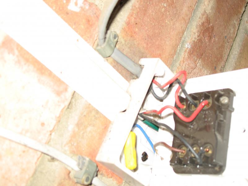

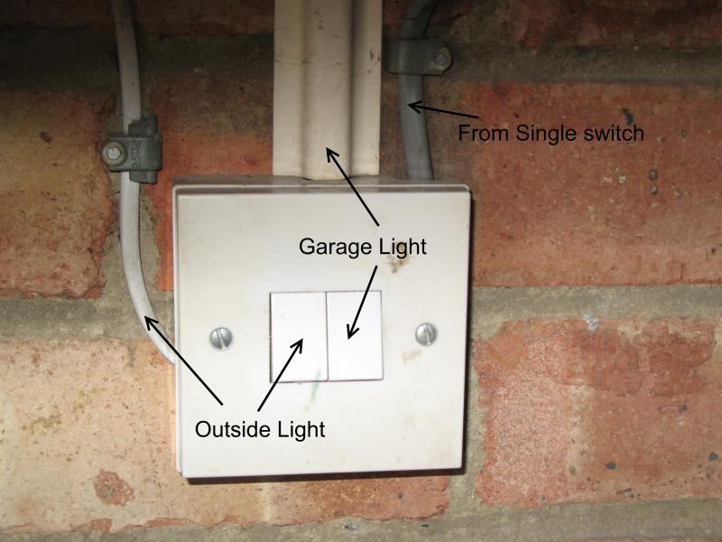

I am just looking at the photo of the wiring and maybe I have given false information.
Looks like the double switch is LHS -> Garage, RHS ->Outside light, the opposite way to which i annotated. (looking at it from the front)

Asolute nonsense :eek: Please explain how the garage light can work (all the time) without a permanant live at the switch.
My post above explains how the 2 way could have worked.
Plese tell us your secret. :)
Look at the picture of the double switch closely and you will see the garage light forms no part of the outside light circuit what so ever. Originally the garage switch would have been a single switch just for the garage light with only a "live" and switched "live". This is the cable coming down to the switch through the capping on the wall, the garage light is probably wired using the standard loop method meaing only a single switch wire is dropped to the switch. Then along came someone and lashed up the outside light circuit (replacing the single switch for a double), the grey t&e to the right of the switch originating from the single switch inside is carrying the neutral (through the earth core) and the two "live" strappers for the outside light circuit, the white 2 core flex then goes to the light.
Also there IS a valid earth at each switch, just not between them as its been used as the neutral conductor for the outside light. As for it being dangerous and to switch it off, umm slight over re-action, its far from ideal but it isnt going to set the house on fire or kill anyone!
As i said look again at the double switch and you will see the garage light and outside light circuits are completely independent of each other :)
