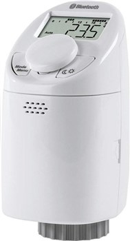

So this pair EQ-3 Bluetooth Smart Radiator Thermostat.jpg ae235.jpg in every room would allow complete independent control of every room, in practice likely two ae235.jpg is all that is required to keep boiler running when required, and only these EQ-3 Bluetooth Smart Radiator Thermostat.jpg in every room. So the TRV head costs around £10 or £15 with blue tooth and the wall thermostat around £35 it is of course important both are programmable. You could go for likes of Hive, but the TRV heads are far more expensive jumping to around £60 for TRV heads which link to the wall thermostat.

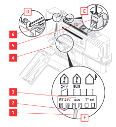

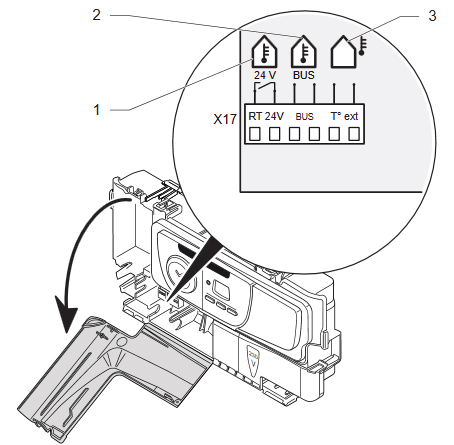

I have made an error, and I will admit it. temp.jpg and temp2.jpg show I was wrong, you can't connect two thermostats in parallel, I have made an error, not sure on the EPH system, I know EPH can be set to master/slave, but not sure if this ebus will work with opentherm? However the same applies to EvoHome unless this boiler will work with opentherm it is a non starter.
However the eQ-3 or i-terrier
eq-3-bluetooth-smart-radiator-thermostat-jpg.213103
can still help, if you reduce the temperature setting on the TRV in room with the wall thermostat it will cause the boiler to run longer, as will closing the lock shield valves.
Personally I would in this case not fit a TRV in room with thermostat, I would simply close the lock shield valve until all other rooms are warm enough, and only fit eQ-3 to other rooms, not room with thermostat.
Sorry did make an error, as did @dilalio @ianmcd @fezster all who like me jumped to the conclusion it was an on/off thermostat not one connected to ebus.
