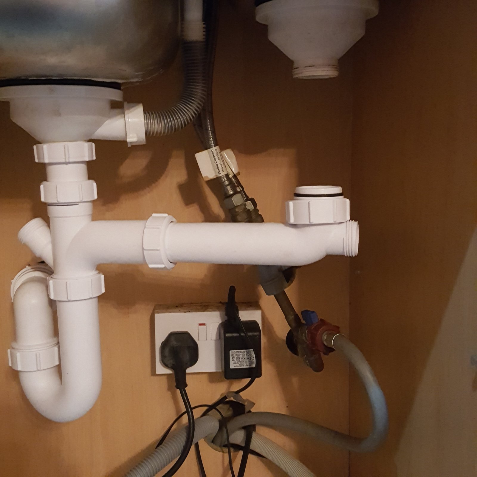

Please can you advise me what kit I need as I've purchased a sink and a half waste kit but as you can see I'm missing a piece.

Thanks but if I reverse the u bend wouldn't be in the correct place
Was the outlet already there, and you just connected the waste up to reach it. If the setup reversed, then you'd need to drill the wast out higher, but you'd have all the parts, and none would be missing.
you have the waste assembly the wrong way around.the trap should be on the right hand side .this will take the whole thing higher ,and the trap further away from the waste pipe that goes out the back of the cabinet.you then need to make up pipework to join the trap to the outgoing waste pipe . a flexible waste pipe may be useful for this.
The assembly has always been this way as I have previously had the same kit installed however the Mrs had a go at fixing it and ended up cutting a piece short so I bought another kit..it looks like I need a 32mm tube with a thread on each end..
I have noticed on the pictures of the sink kits online that the bowls or opposite yo how mine is installed
Just as I suspected, you've got the kit, and are trying to fit it the the existing setup. Kits are designed to start from scrath, not always for retrofitting, bascially because the waste will end up in the wrong position. Best to take the photo to a local plumer merchant, and they'll fix you up with the necessary bits. Bowls can be fitted either way, so it's not an issue.
depending on the length you need to make up on the right hand waste , a 40mm trap extension may do the job Marley do one called " trap inlet height adjuster " and the useable length is 100mm. B & Q stock them.
