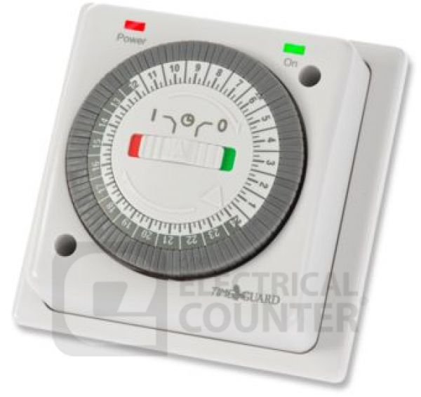

I have one of these:
And I am trying to find a switch that will allow:
- Switch to 'On' and 'Sink' for 1 hour (enough time to heat the water for sink and so that I don't need to remember to switch it off after)
- Switch to 'On' and 'Bath' for 2 hours (enough time to heat the water for the bath and so that I don't need to remember to switch it off after)
- Switch to 'On' only at night (so I can use my night electricity rates)
Nice to have features:
- Some way of telling if heating is still underway (so I know when there is enough water for a bath)
- Wi-Fi enabled so I can do all of this from my phone or better still Alexa
So such devices exist?
Thanks!

You are making this far too complex for nothing achieved.
The concept of those 'bath/sink' switches predates E7 and cheap overnight electricity, and have no real use today.
If you have cheap overnight electricity, then connect the lower 'bath' element to the off peak supply, or if that supply isn't separately switched by the electricity supplier, install a timer so that it's on at the cheap rate times.
The cylinder will be heated overnight at cheap rate, the thermostat in the heater will switch it off when it gets to temperature.
Unless the cylinder is tiny or you use vast amounts of hot water, that should provide most or all of the hot water at a cheap rate.
For the other 'sink' element, get one of these or similar: https://www.tlc-direct.co.uk/Products/SMSTBT4.html
which would be used to switch the upper element on for a certain time if required, and then switch it off. If it gets to temperature before then, the thermostat in it will switch off.
If the cylinder is old and has thin orange foam or no insulation at all, then get one of these: https://www.screwfix.com/p/cj4218bssf-four-panel-hot-water-cylinder-jacket-42-x-18-/43483 to insulate it.
If the pipes from the cylinder are not insulated, then get some insulation for those as well, as the pipes will have significant heat loss.

Amazing thanks, whilst I appreciate the help on getting this setup with WiFi from the other guys, even if I get a professional to make me one I think I would always be a bit concerned it might be a fire hazard.
So what you suggest sounds like the way to go. The cheap electricity doesn't come from a separate supply so I think it will be as simple as connecting the 'Bath' element to a timer and the 'Sink' element to a boost box.
2 questions come to mind before I undertake this:
- Using this setup will remove the switch that only allows one element to be on at a time. Am I right in thinking I shouldn't have any concern of what happens if the Bath and Sink elements are on at the same time, since the thermostats will just disable each of them? So this settup if perfectly safe in this regard?
- It would be nice to also have a Boost option for the 'Bath' element, do timers with boost ability exist? If so it might make sense to just install one of these for each element then I have a lot of flexibility.
Also thanks a load for the suggestion of the insulation jacket, the tank has a thin layer of orange foam just like you say

There is no point. It is the same water being heated whichever you choose.
The 'bath' and 'sink' labels merely relate to the amount of heated water needed.
Agreed, though they heat different volumes of water which is what I would like to achieve whether through the timer, or through boost
As I said, there is no point.
The 'sink boost' boosts the 'bath' as well; it is the same water.
Ahh, there was me thinking there were 2 separate appliances on the end of that changeover rather than 2 imm heaters in 1 cylinder.
If you improve the insulation on the cylinder you'll retain more energy
