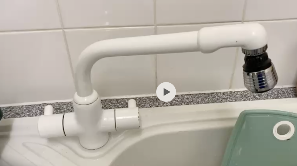

Anybody knows the brand of this sink mixer for I need to change the cartridge due to leaking. Tks.
Not just by looking, you'll need to remove it, measure it carefully and try to get a matching one. Or just change the tap.
Buy from Tap magician.
You will have to match it.
Problem is they can break apart when you remove so you might be without a tap for a few days
I hv visited Molseley and the staff said
Deva SMS172-005 Sauris White Mono Sink Mixer's cartridge is NOT what the original picture's one. Either change the whole tap or go to the original manufacturer for the cartridge. But the problem remains: who is the original manufacturer?​
Tks to all for your advice.
I have dismantled the arms and took out the cartridge to the shop (including Molseley) to find matches, still no avail.
There are several online resources where you can order a replacement. The problem is there are dozens of them available all with slightly different dimensions so you will need to measure the cartridge very carefully with a Vernier calliper in order the correct item.
So much simpler to change the tap, now all the simple and sensible things have been done... Only thing to be aware of is if the HW is mains pressure or from an unvented HW cylinder (low pressure), when some taps will not be suitable.
