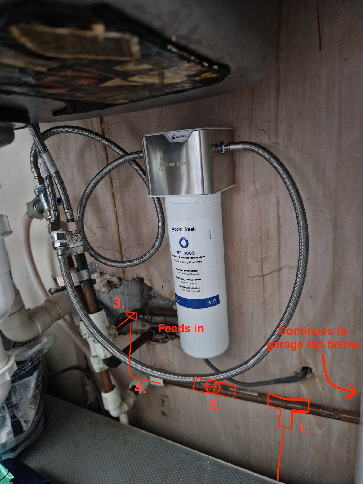

I've always known the pipework under our kitchen sink was a mess since we bought the place a few years back but it's never caused an issue so I've never got around to sorting it.... I now need to add a feed for a new plumbed in fridge so it seems like a good time to tidy it up a bit, just wanted to ask a couple questions on what I'm thinking...
I think the obvious big problem at the moment is the pipes are just hovering in the cupboard.... they're not fixed to the wall with pipe clips at all. I've put together a basic picture to show what I was planning, the water filter pictured is going to be removed as the fridge will have one so that can be ignored.
Image numbers:
1. New Tee added to feed the fridge. I'm hoping to use PEX for the line to the fridge which is the other side of the kitchen so I can get a single continuous run thanks to the clear route under the cabinets. I think if I use a push fit tee here I can combine both copper and PEX as long as I pop a SS insert into the pex pipe first. This is around 6m to the fridge so according to the manufacturer this is too far for the fridge supply feed itself.
2. Full-bore compression/pushfit isolation valve, just so we can turn off the feed to the garage and fridge when I need to replace a filter - unless there's one on the fridge feed end (?).
3. Pull both the hot and cold feeds closer to the wall so they're not sticking out so far and can be securely clipped to the back wall.
4. Hopefully this pipe will then align with the base of the cold tee so will just need an elbow fitting up to the tee.
5. Enjoy chilled water from the fridge.
I have no idea if these existing push fitting are demountable but I can cut the pipes if not anyway. I'm really just trying to decide what fittings to replace them with, everyone seems to have their own opinions online and there doesn't seem to be a consensus (unless it's pure solder). I've used quite a few compression fittings over the years but I've never soldered (wouldn't mind learning). I've just discovered "Yorkshire" fittings with the solder within, seems like they're easy and cheap enough but I'll require a £40 odd blow torch first. Alternatively "Tectite Classic Push Fit" fittings which are cheap for a one-off job, look much nicer than the big plastic ones and couldn't be easier by the looks, these don't feel like they'll last as well but I'm sure they do! Added benefit of being able to join the PEX pipe directly into the tee rather vs the yorkshire fitting?
Any thoughts welcome!
