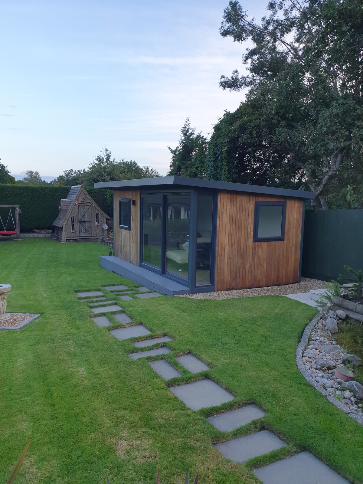

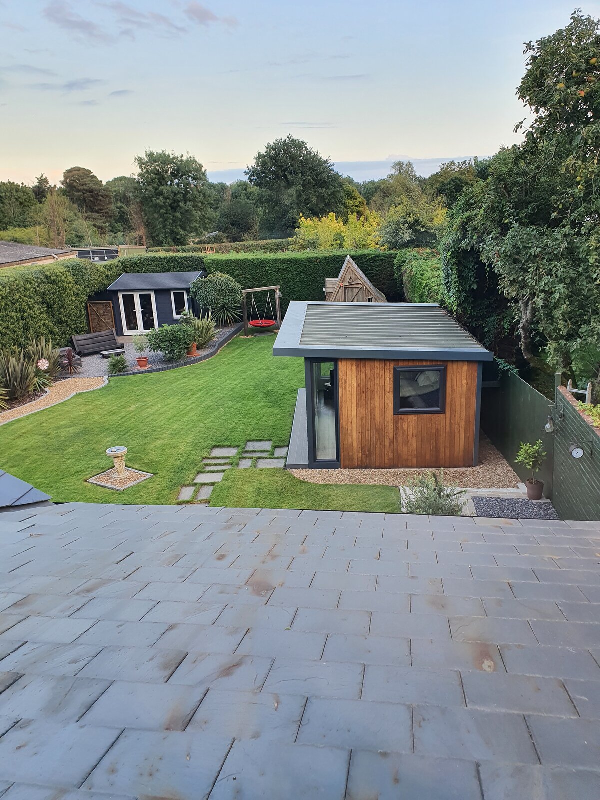

This is the izo panel roof
I clicked the link in the original post, the roof is fine with 100mm of insulation, the walls and floor aren't. 25mm is no where near enough. You can address the floor by standing it on an insulated concrete slab. (hardcore + sand + 50-100mm of polystyrene then a concrete base.). The U value for the roof will be about 0.2, with the insulated base the floor will be around 0.19. The walls will be about 0.8. To keep it warm in the winter is going to need about 800-1.2kw of heating. I guess they cut down the wall insulation because there is a lot of glass and doors.
