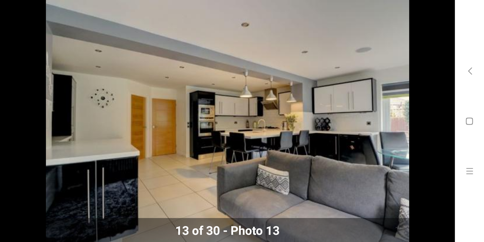

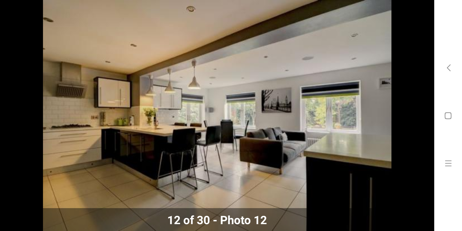

We have recently moved into a large property (3000 square foot ) and it has 2 X double extensions on it .
Both of the extended parts of the house have large steel beams supporting the 1st floor joists .
The rear extension has an open plan kitchen with a approx 7m steal RSJ supporting the joists above .
The problem I'm having is that above this part of the house is an ensuite and the extended part of my son's bedroom.

Plywood just won't give you the extra strength or stiffness you require - structural plywood doesn't work like that. Similarly strutting (solid or herringbone) confers stiffness (reduces bounciness) but doesn't add much strength, as you have discovered.
The right way to approach this is to install timber joists of the correct size and structural rating. That will give you a level floor capable of carrying to load with acceptable deflection but will raise the floor level.
Sistering the joists with 7 x 3in C24 timbers (bolted to the originals with M12 coach bolts on centres no greater than 600mm - C24 because it is stiffer than the C16 grade normally specified for domestic builds) would get you quite some way towards where you need to be, especially if you add solid strutting on multiple centres, and may be enough to cure most of the ills of the floor.

Its a recognised fix and depending on the deflection will probably fix it.
Only ever used steel flitch plates. The structural engineers we work with (Arups on the last 4 structural projects I've been on) won't countenance plywood flitch plates because of the problems in getting performance data for plywood in this sort of application, not to mention the impossibility of calculating the strength of an on site produced glue joint. They tend to Insist on proper sistering of joists
Screwing or nailing the sub floor into the edges of the plywood, causing delamination, won't do much for its' strength or integrity, either

The steel plates really need structural calcs to be done if only because of the weight issue - badly done the extra weight of the steel could exacerbate the dip in the middle rather than stop it. And you'll still need to add packers to the tops of the joists to carry the floor. Note that it is also possible in some instances to install an extra bearer steel beam below and at right-angles to the joists. These can be sectional (for ease of handling) and will often be hidden inside tight boxing or even inside walls
The reason we often sister is to level the floor whilst keeping the cost down and being able to work from either above or below. Flitch plates, for reasons of weight and safety, are normally installed from below using a Genie lift or the like
As an aside I did wonder if the joists were crowned and some muppet installed them crown down by mistake (it should always be crown up)
