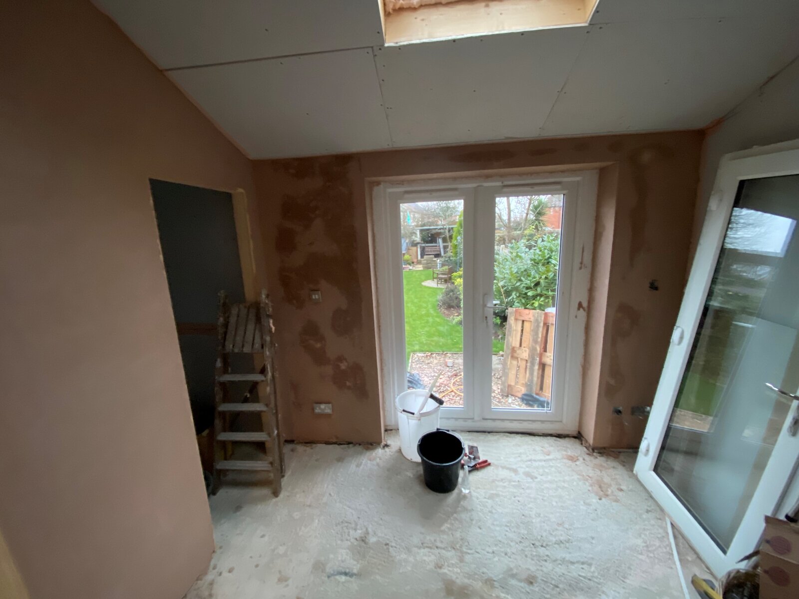

Just thought I'd update on this. I bought some of that Gyproc self-adhesive scrim tape and it's top stuff. Pushed right into corners so there was a sharp crease down the middle and has stuck down well everywhere. The last time I'd used some on an upstairs bay window I found the tape barely stayed on so it was a welcome surprise.
Started skimming on Sunday and did about 12 sqm. Really pleased with the results -- got the first coat on quickly without messing about and then when tacky the second coat went on to achieve a really flat surface. Smoothed out with a wet trowel when starting to dry.
Unfortunately one small area only received one coat. I mixed up the last bit of the bag, applied it to the wall but had ran out of enough Multifinish to do the second.
As that first coat is now dried out, am I best applying a coat of PVA/Water (50/50 mix) and skimming over the next day? It's not a bad finish to be honest, but it's not quite level in some areas and I'd prefer to get another coat on.
PS, please ignore the gap between two of the boards on the ceiling! It's about 7mm and is the only cock-up I'd made boarding.

you can either wait for it to dry and sand it back lightly or feather it in with multifinish after sealing the area.
I never water pva down , but I know most plasterers and pva manufacturers recommend it . your choice
