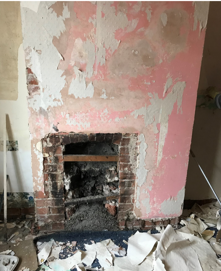

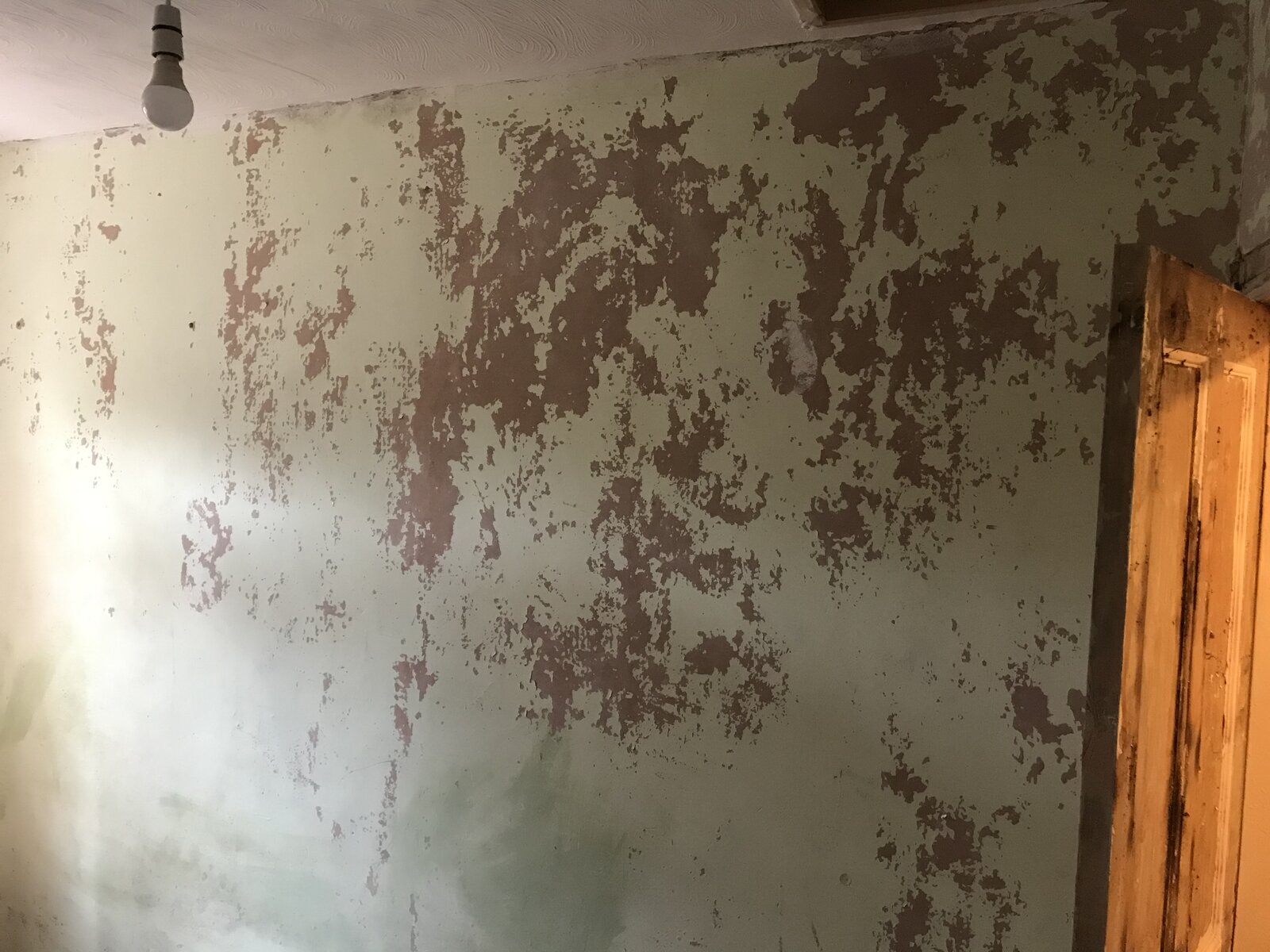

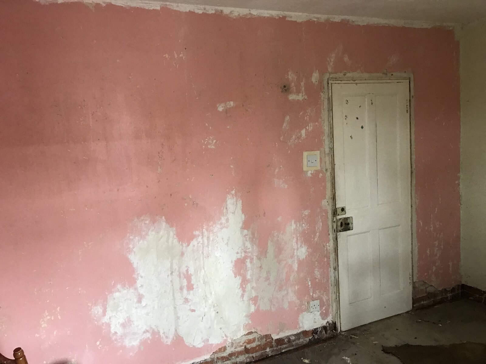

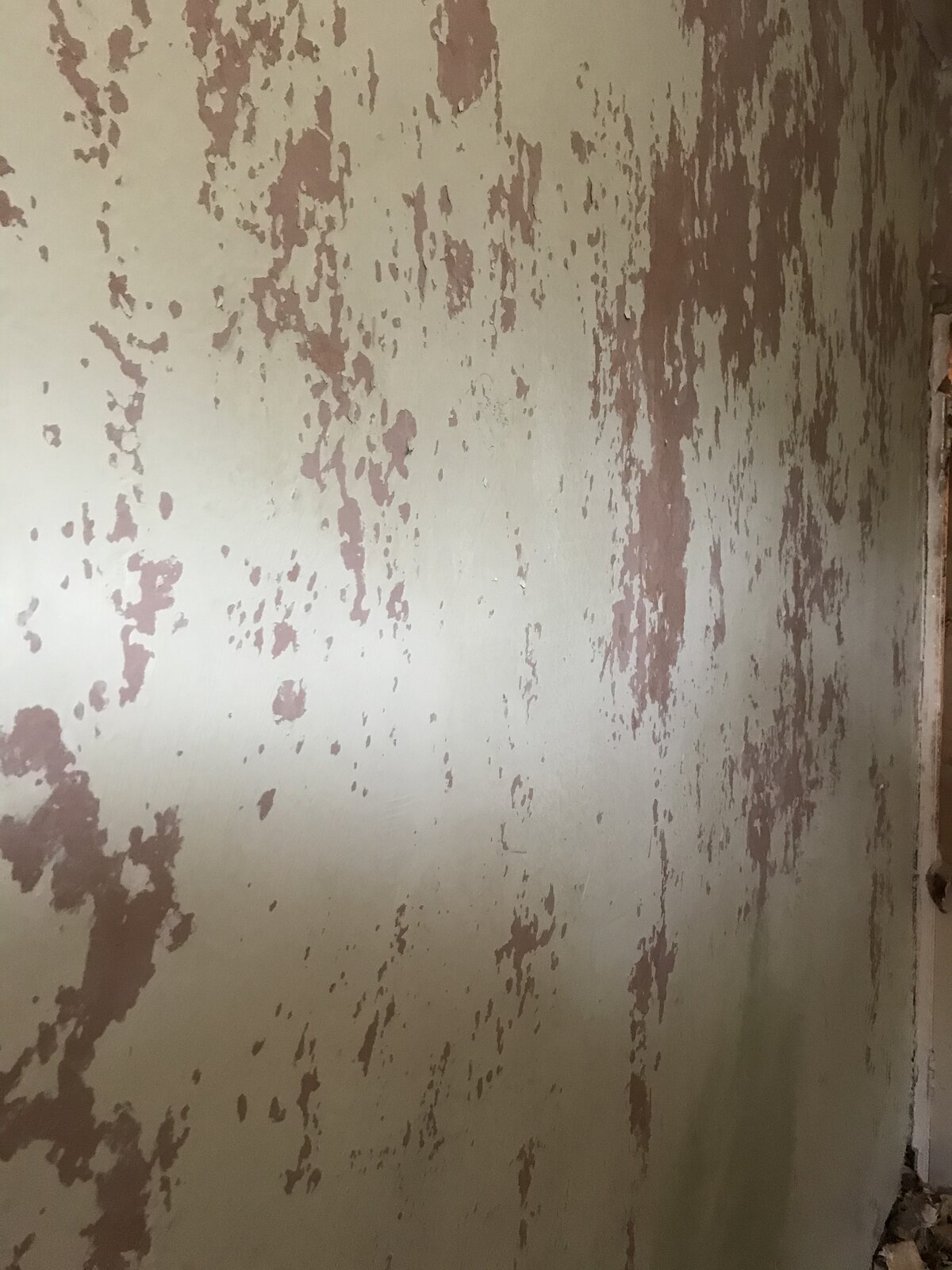

I’ve got these walls that I’ve ripped painted wallpaper off. The walls require some attention prior to painting - as seen in the pics.
I’ve never done any skimming but have used easifill across reasonably large areas. I’ve applied this using my 12” jointing knife.
I’ve come across videos similar to this and am wondering if I can adopt this approach in my situation:
I hope you understand why I am proposing this. I look forward to your responses.

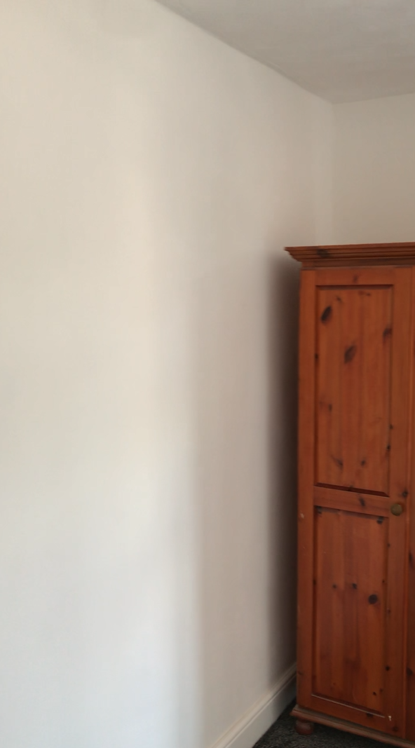

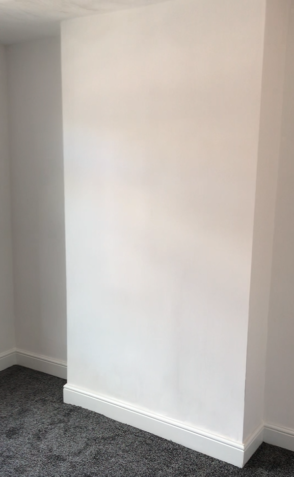

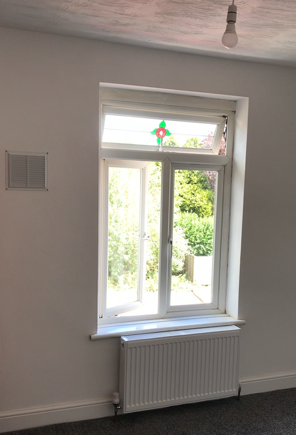

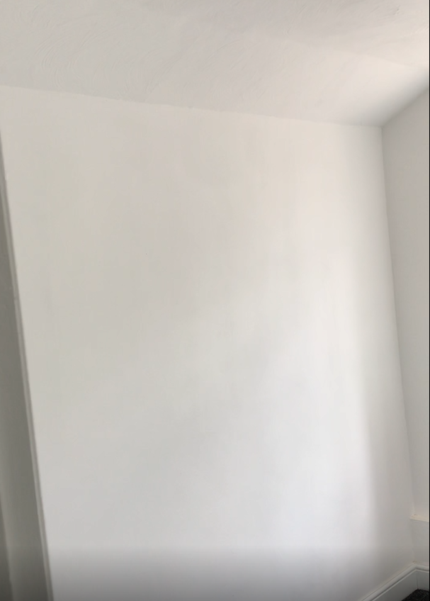

For the benefit of others, I have now used easifill on 3 different rooms and achieved very satisfying results. It's required 3 coats on each occasion and because it smooths out so well, very little sanding was required. Here are some pics.
As a reminder, the chimney breast in the above picture looked like this prior to applying easifill.
I got the occasional bubbling for some reason. I popped it and recoated with easifill. I also used a very thin coat of easifil as my final coat and this had a very smoothing effect.
Happy to answer any questions that may help others.

I boarded the damaged section and then blended it all in using easifill. I also fitted beading on the external corners of the chimney breast.
What do you mean by venting?
If you block up a chimney you should really:- Get it swept thoroughly to help prevent leaching and acid formation, Check it has a rain/bird guard/cowel at the top, fit a vent where it was blocked to allow air to circulate up it. You might not have any problems if you don't but you might also end up with it becoming a wet soot chamber. Mine had around 40 kilos of wet soot behind when I re-discovered it and re-opened it for a wood burning stove.
This looks fab. 15kg of Easifill for all the walls and it's 3 coats each. That's not expansive at all. Did you also seal with Gardz like the video?
@Jupiter01 - when you did this on the chimney breast shown above, how did you prepare the surface? Did you use the Zinsser product in the video, something else, or just skim after taking off any loose bits?
Dusted it off. Applied diluted PVA and then several coats of skimming
