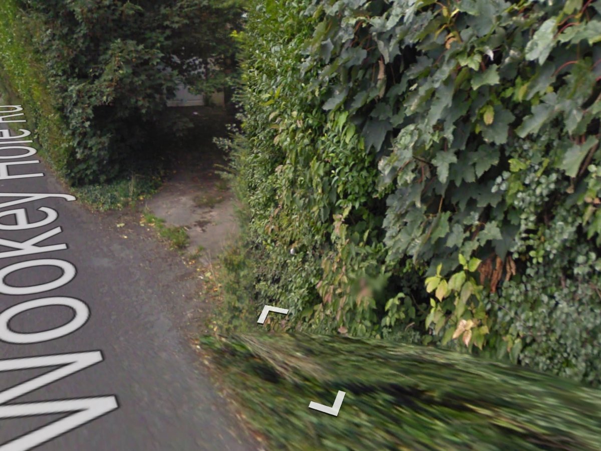

Can anyone comment on how much space a skip lorry needs, and how flat the ground needs to be?
We're considering getting a small skip for some work at an elderly relative's house. There is limited space at the front, and lots of neighbours cars, but there is also a driveway at the back of the house and we're considering putting the skip there. But this driveway is quite steep and narrow. It joins the road at the bottom almost like a slip road.
Sorry I don't have a photo; here is a Street View screenshot. My recollection is that it is steeper than it appears there, but I've not visited for a few years.
if its a bit tight you can push the skip back clear off the road/path
then when they come to pick it up they will extend the boom drag the chains back to the skip pull it forward till there's enough room to get to it properly
Thanks. Does that photo look "a bit tight" or "impossible" to you?
I know it's a hard question..... but your collective wisdom is better than the alternative of guessing!
Skip lorries are 8 foot wide plus the width of the mirrors, midi skip lorries might be 7 feet (if your particular company has them). They can handle a fair bit of camber and steep hills. I'd say, from looking at the screen shot, that you'll get a skip at the start of that opening but you won't get the lorry down there without widening it.
