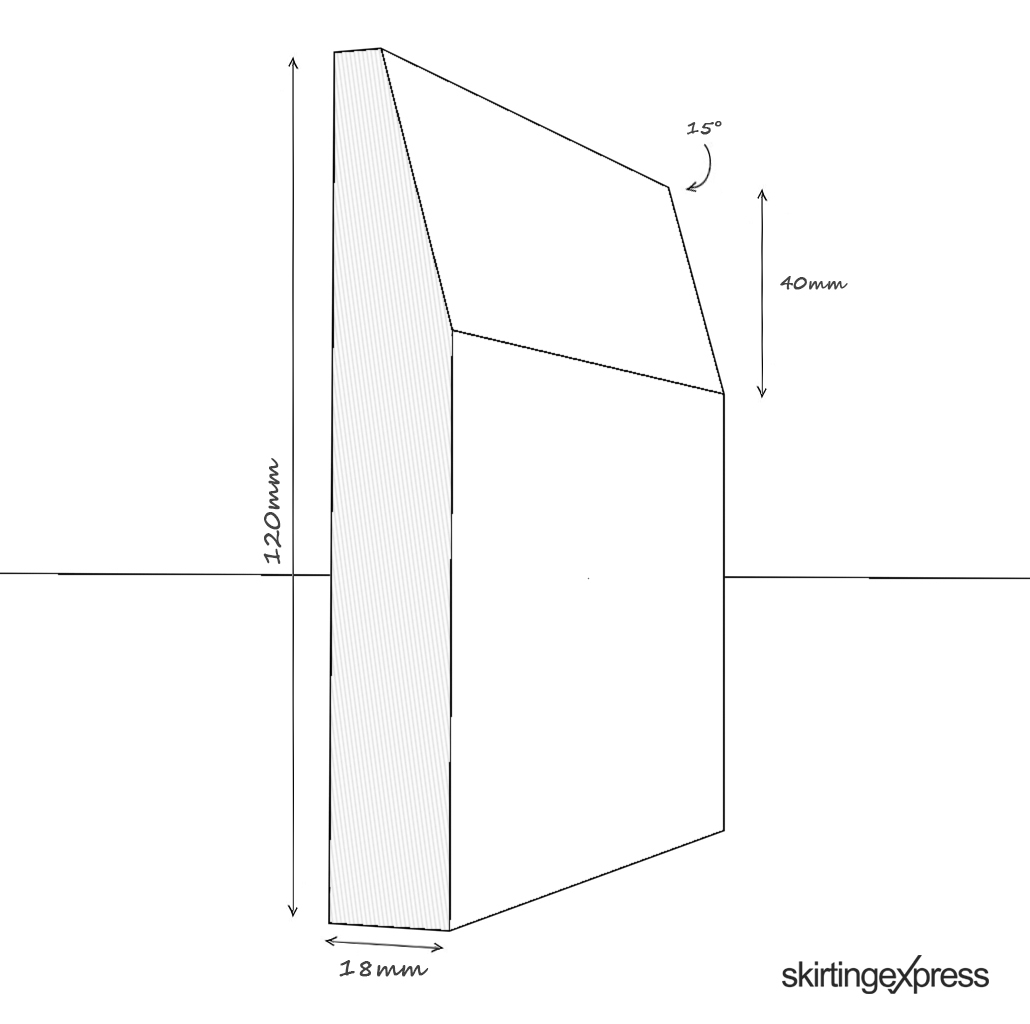

Renovating a 1930's room, we ripped off the skirting board that was damaged ready for plastering, leaving a 4 meter length of the original skirting (under a bay) and some on one wall up to the door, as it was not damaged. I was told I could easily get to profile match.
Anyway had the room plastered, did the floors, and today the chamfer skirting was delivered and the profile detail is the wrong size. I was told it was 40mm when it's 25mm.
They said they don't do a 40mm (i did make it crystal that was what I wanted).
Now I'm not sure what to do.

When you say 25/40mm what do you mean?
Is the timber just thicker? But visually it looks the same ?
Have you enough new to replace the existing stuff ?
I mean the chamfer profile detail. In the image, where it shows 40mm. This is what I asked my local supplier for and instead they delivered 25mm. Maybe they to didn't understand but they didn't ask for clarification unfortunately. They have now confirmed they don't do 40mm.
I have enough of the new skirting to replace everything but I am worried as I have spent money getting the wall plastered and sanded all the floors. So if the skirting is ripped off then I am concerned the damage it will cause.

Return the skirting and check out Other timber merchants or the MDF range in B&Q Think that 119 x 18 mm . The only other way is if you know anyone with a Router table to cut the correct profile.
Lever off from one end, level with skirting so reducing any damage above skirting .
Thanks. I ended up getting it made bespoke as all the chamfer profiles didn't match. I thought it was the less risky option as the walls behind the skirting just seem like rubble with a gap behind.
