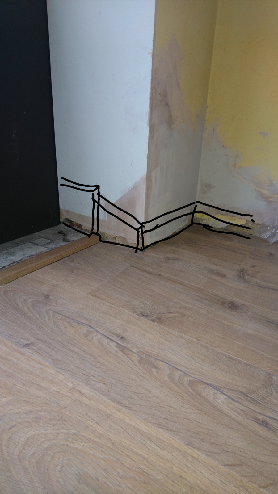

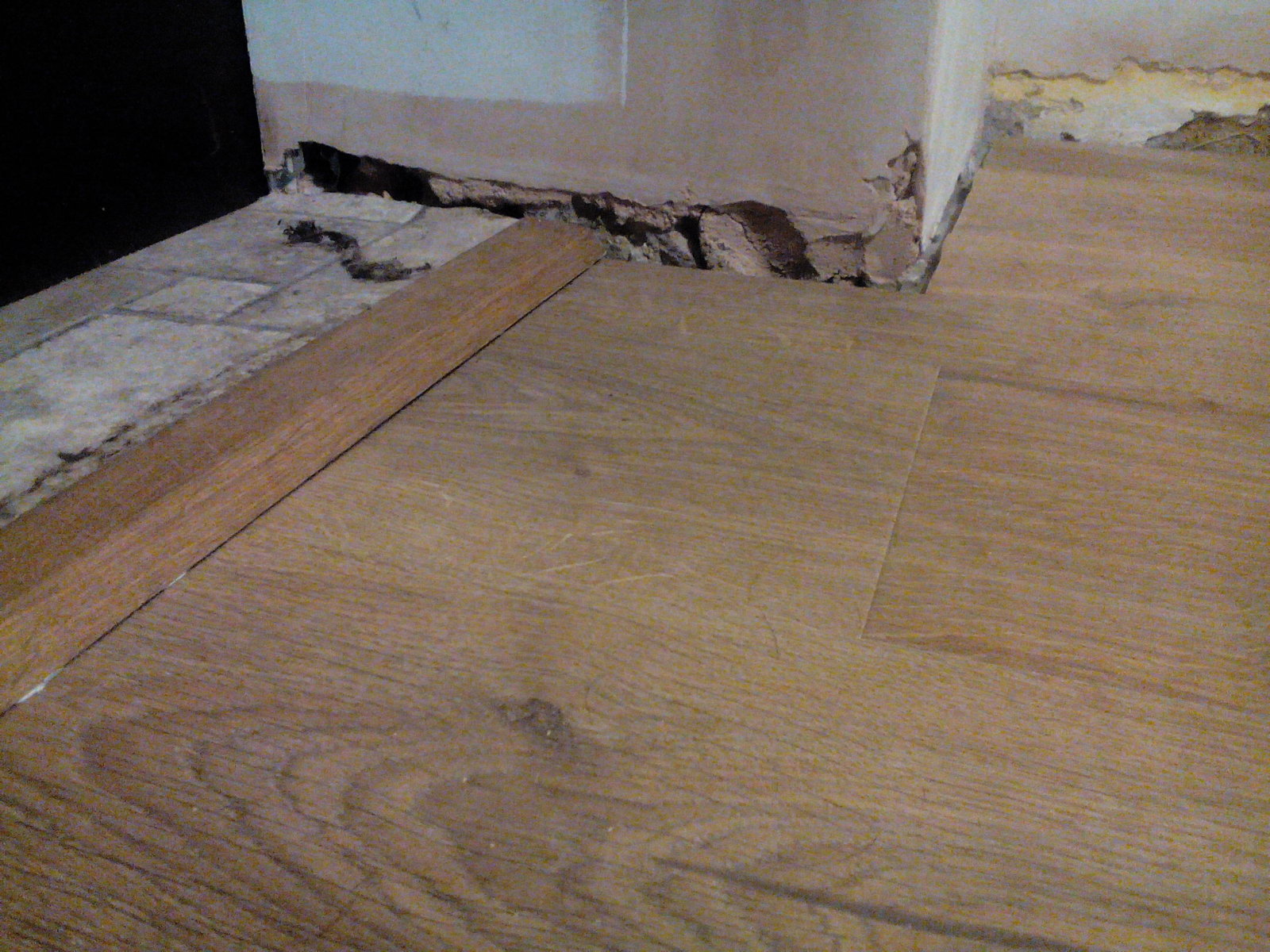

Hi, I've been searching the best looking / most logical way of fitting skirting from my living room up into the conservatory that are on slightly different levels.
The living room has just been done in laminate, while the conservatory is padded vinyl. Ideally I'd like to use the same skirting for both.
The difference is approx 20mm at the threshold which used to be the rear wall, but now an open dooway.
Would a "skirting block" be appropriate?
Thanks Chris

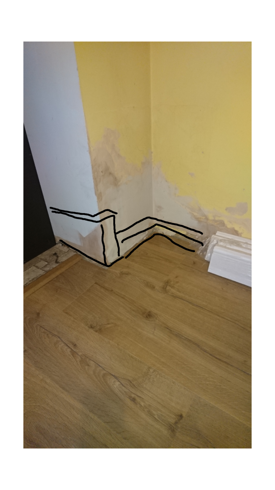

Thanks bobasd, one more detail question: How would the block meet the skirting?
Would the block be the same size as the short arch wall and finish the skirting next to it?
Or overhang the arch wall by the thickness of the skirting and butt to that?
Or make a three sided block to return around the corners by an inch or two, and butt the skirting to that?
( Like the attached image, but around the "doorway", and without the moulding up the wall)

This was my idea: three sided "block" over the threshold and around both corners.
Hopefully, the two different skirting heights wouldn't be obvious.
The skirting is 19mm thick, so block would be 20mm+ and would be taller than skirting in conservatory (left of doorway) and taller + step height in living room.
Does that make sense?
So the only obvious slope/step would be on the face of the wall with the threshold bar, and no need to trim 20mm or so around the whole conservatory.
And for balance I would make the same block on the opposite side of doorway, even though the step is smaller.

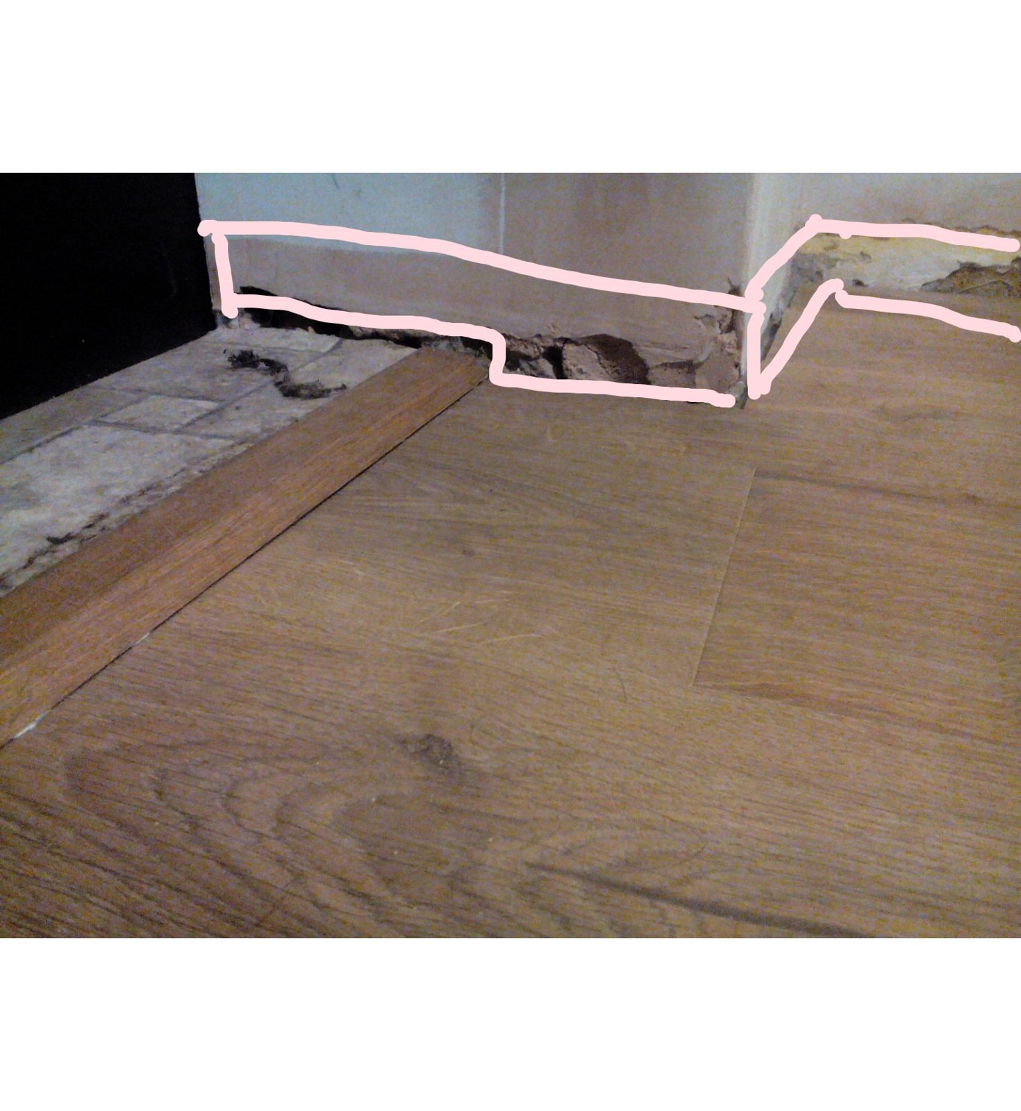

I think it would look better, with each side retaining their full skirting height, with a triangular piece set in to the RH edge of the threshold at 45 degrees - so the upper profile is maintained. So skirting on left, would finish square, meeting the triangular wedge piece.
Like this -
¬\____
