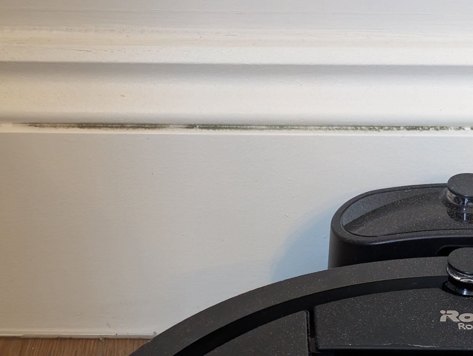

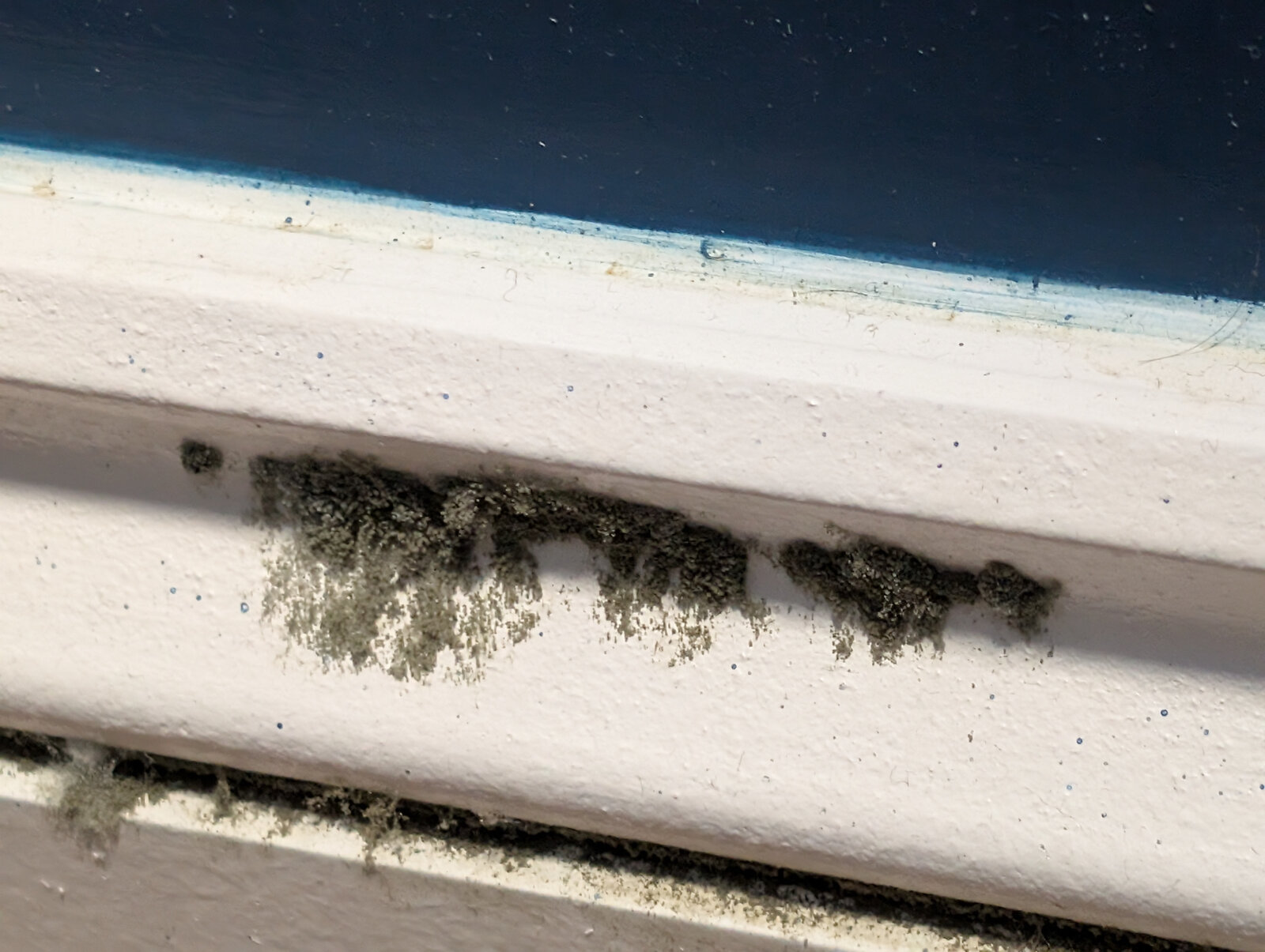

Now, mould is growing only on the skirting board.

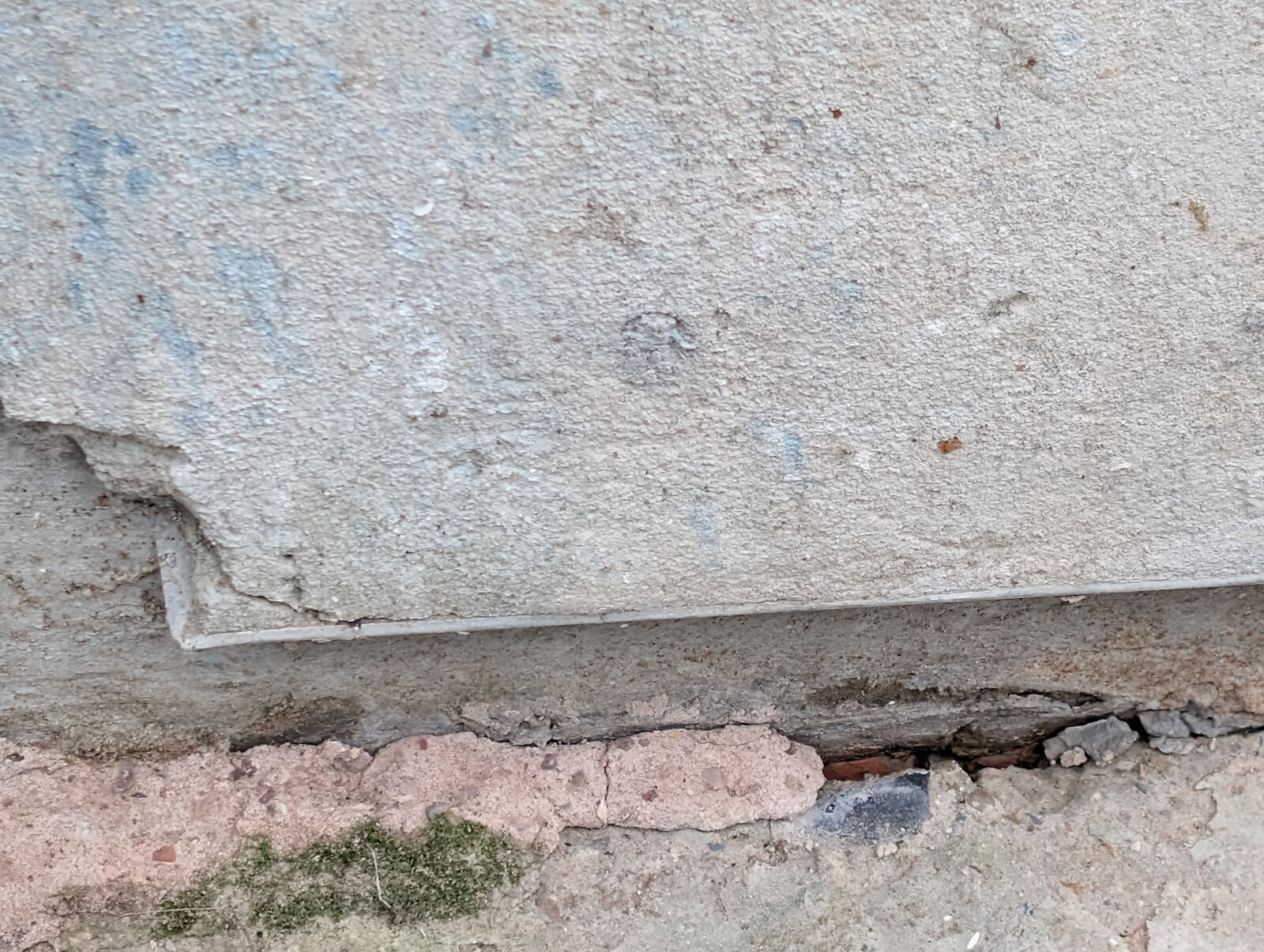

There is a gap between the house and the external pavement.
Should I fill the gap with cement? What kind of cement?
Should I paint the wall with waterproof paint or Masonry Creme (lets the wall breathe and is water repellent) ?

Where is the DPC, relative to ground or paving height?

The DPC is 15 cm above the external ground.

I mean, the Damp proofing course inserted in the external walls is 15cm above the external pavement.
The DPC (Dam proofing course) is the treatment where they drill a hole in the brick and insert some plastic.

I'm not sure where you mean the real (slate) DPC is, relative to ground or paving level.
That will be enabling watersplash into the wall. And I presume the original airbricks will be blocked.
Is there any scope to create a gap?
No, I don't have the money to do it. In the future, external polystyrene isolation will be done on the wall.
Right now, I will fill the gap with cement and paint the external wall with paint that allows the brick to breathe.
Also, the company that did my DPC said I can't have MDF skirting board so that I will replace with real wood ones.
Filling the gap will make it worse.
If you think the wall behind the skirting is damp, I can explain how to isolate it.
This will space the skirting off the wall.
